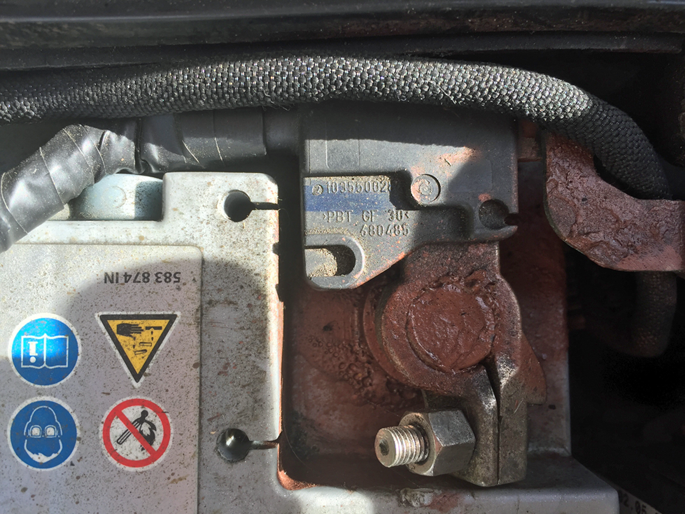

Unfortunately it may be something you'll have to live with. I too never get any more than a few minutes on economy mode. The system is supposed to give you double the time the car has been running - up to a max of 30 minutes, but never does - even with a new battery. If you have your VIN I can check if you have the Battery Charge Status Module fitted too.
Most of these units have been replaced with a different unit - from about February 2011. I was going to do mine - but hacking away at the battery wires put me off, so left it. I have a saloon, so can live with it as is, but with a Tourer it can be pretty frustrating. Anyway I can confirm which you have from your VIN.

Ok, so you do have one of these little beauties John.
The biggest problems with these units (and I cannot say that any of the replacement units would make any difference) is the tailgate issue for estate owners. It is well known that the unit is too sensitive and adversely affects those with electric tailgate units.
Although I do not have the Tourer, I am currently undertaking a test of a procedure that may circumvent the unit - I will report back later....
