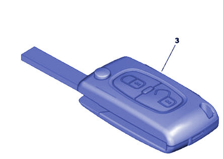

Right - so you've got the wrong one then. The one specified for your car's VIN is a 2 button one. Your model isn't compatible with the 3 button fob electronics.
6490FS (uncut)
6490FT (Cut)
6490FS (uncut)
6490FT (Cut)
