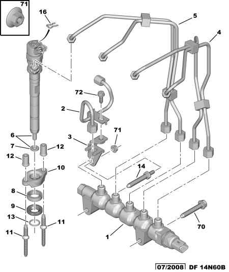

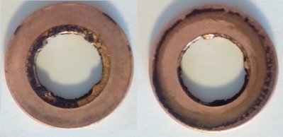

I have C4 1.6 Hdi 2009 200 000 km and cylinder 4 injector is leaking slightly. I am second owner from 140 000 km.
I renewed 4th cylinder copper seal and I noticed that the injecteor nuts had been thighten imbalanced.
Is it possible that PSA engine factory is making mistake balancing the injector clamb band wrong ( 10 ), so that it is not in balance and the injector is leaning slightly ?
If you are thightening the band when it is not in balance, you easely snap the bolt.

I have bought all the seals and the studs ready to do my daughters 207 but the stud issue is causing me some worries. Doing lots of reading before I start, as you do, and I have found a few horror stories of the studs snapping in the head when you try to remove them. Are these studs a bit of a problem to remove or are the stories just one offs and I shouldn't be worrying?
Cheers all....
Cheers all....

Studs are steel and sylinder head is aluminium, so these bolt are stuck, so better ask some specialist firm, that can they do it and at the same time
lining the head.
lining the head.

I have 7.5 Nm and remember to tightens the bolt at the same spanner level. The copper seal is expanding
because of heat so when the engine is running the bolt torque rises to ~10 Nm.
Pipes you have to renew !

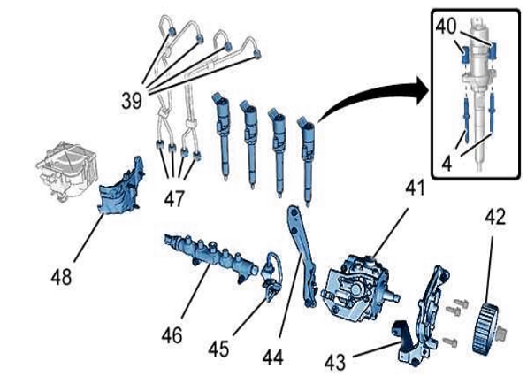

I would be aware that different manufacturers implement different injection systems to the same / similar engines, so caution is advised when ordering parts and I suggest that you always ensure the correct part numbers are used.
In this case, concerning injection, you mentioned Delphi parts - yet the PSA 110 DV6TED4 engines I have looked at this morning have Bosch injection systems. Manufacturers also make different decisions on the type of injection they use (Piezo / Solenoid) which of course has cost considerations.
The Delphi system is of course used on several other engines in the PSA range, but concerning their DV4TED engine specifically, that is a 1.4 HDi.
So as far as the tightening torque information below is concerned, this is specifically for the PSA DV6TED4 110 80KW Euro 4 engine:
| Reference | Designation | Stage | Tightening torque |
| (4) | Diesel injectors fixing pillar screws - Camshaft bearings covers | Pre-tighten Tightening | 0,5 daNm 1 daNm |
| (39) | The unions on the diesel injectors | Pre-tighten Tightening | 2 daNm 2,5 daNm |
| (40) | Injector mounting flange nut / Pillar screws (4) of the camshaft bearing cap casting | Pre-tighten Angular Tightening | 0,4 daNm 75° |
| (41) | Diesel injection pump on support | Tightening | 2,2 daNm |
| (42) | Diesel injection pump pulley | Tightening | 5 daNm |
| (43) | Diesel high pressure pump front support | Tightening | 2 daNm |
| (44) | Diesel high pressure pump rear support | Tightening | 2 daNm |
| (45) | Connector on high pressure diesel pump | Pre-tighten Tightening | 2 daNm 2,5 daNm |
| (46a) | Fuel high pressure common injection rail on the engine block | Tightening | 2,2 daNm |
| (46b) | Fuel high pressure sensor | Tightening | 4,5 daNm |
| (47) | Fuel high pressure common injection rail unions | Pre-tighten Tightening | 2 daNm 2,5 daNm |
| (48) | Fuel filter support | Tightening | 0,7 daNm |
