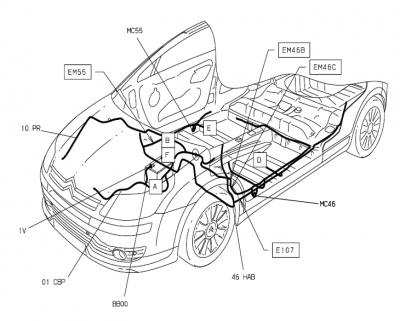

Finally, I can suggest that if you've been cleaning the floor area by the left hand side (LHD Driver's Side), check the wiring that goes back to the BSI under the carpet as shown below:
Also the earthing point for the seats is MC55 and that is located here:
