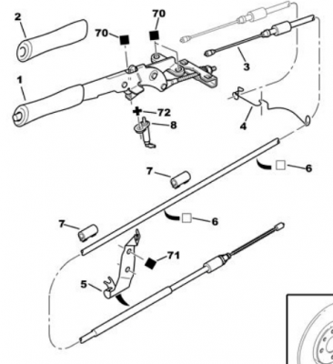

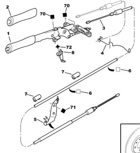

If it's number 5 in the diagram, then that ebay one won't fit - it's not the same part number and looks different.
There are 2 part numbers -
476907 - Left (available from Citroen @ £16.55 inc. VAT)
476916 - Right (No Longer Available)

Re: Rust inside engine bay
Yip - its number 5.
