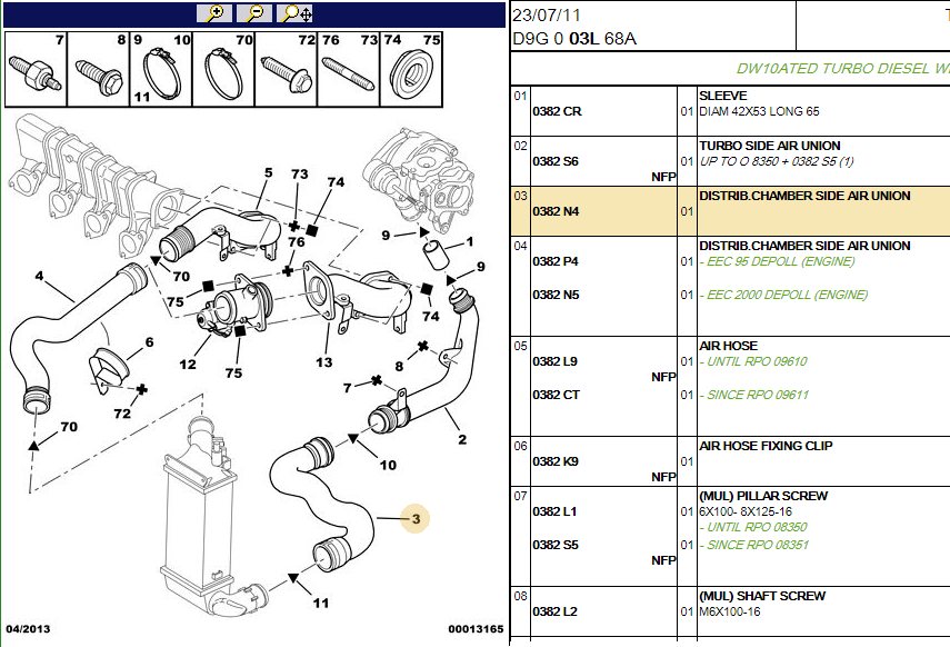

0382N4 is only listed on PSA's diagrams for a DW10ATED (2.0 HDi) in a 406 so not even close!
- x 6961
Re: Citroen C5 X7 09 plate limp mode
Jbbu is absolutely correct - the 0382N4 hose is only listed for the Peugeot 406 and not even listed against any Citroen models as you can see and the part looks completely different:
| Peugeot 406 Turbo Air Piping |

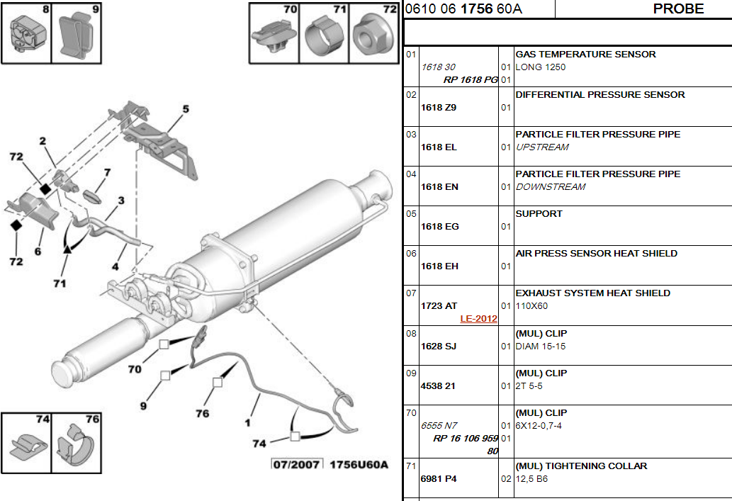

Hi Rick, the P1447 code is: Differential exhaust pressure signal: Clogged particle filter. Now that can mean the sensor is faulty as opposed to the particle filter being clogged - or if there is a leak then the readings are going to be out of kilter and throwing the warning.
Click to Zoom
I'm not exactly sure what you mean by the 'Flexi' - but on the right table is a more detailed view showing the longer parts of the pressure pipes and some of the other components.
If this is not right, just let me know.
Click to Zoom

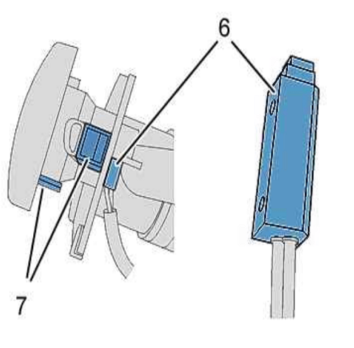

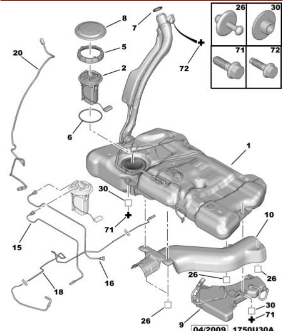

Hi Rick, the fuel cap (not the flap) has magnets mounted on it thus:
So the permanent magnets are '7' in the first diagram and the plug presence detect harness is '6' and can be seen on the second diagram part 20.
This harness is £135.88 (inc. VAT) from Citroen and is part number: 6534PF. Its role is to inform the BSI of the opening and closing of the fuel tank cap and secondly, from that information detect that fuel may of been added. So when the cap is closed, the magnet is opposite the contact.
As for testing:
Allocation of channels of the connector:
- Terminal 1: 5 volts supply
- Terminal 2: signal
- Presence of the magnet opposite the contact: Resistance = 150 000 ohms
- Absence of the magnet opposite the contact: Resistance = 15 ohms
