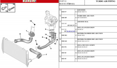

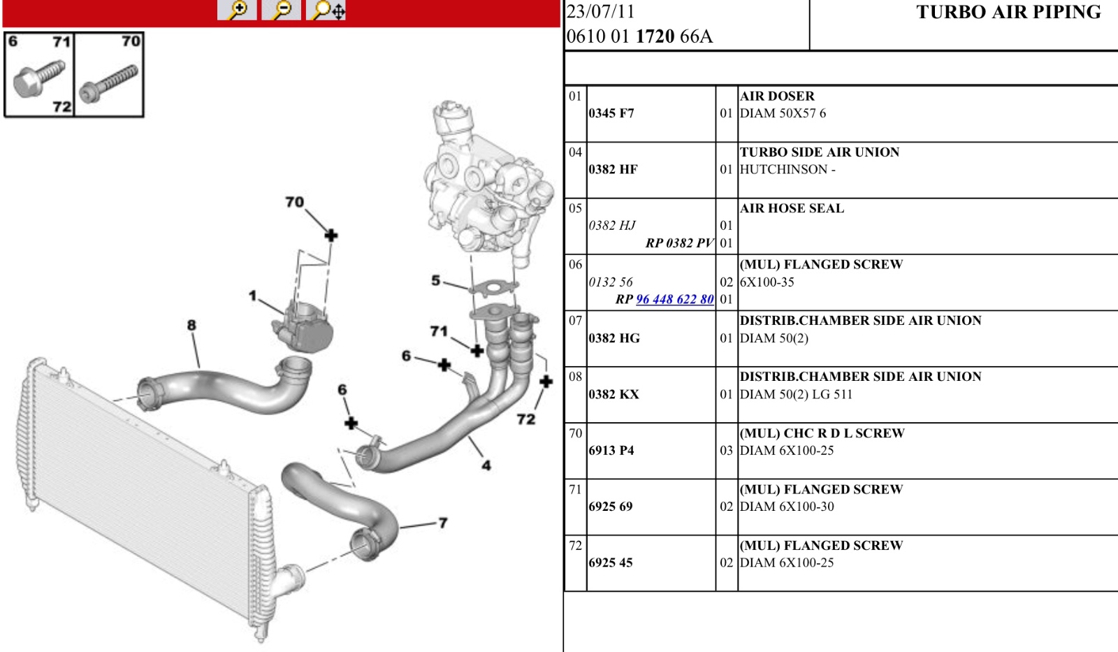

Here’s the turbo air piping with the part numbers. Let me know which one it is and I can advise of the OEM price.

Re: Citroen C5 X7 09 plate limp mode
Hi the part I need is number 7 if you could give me the part number would be a great help and would that cause all the other problems and not revving above 3000 revs

Gummbo wrote: 20 Aug 2018, 14:10 Hi the part I need is number 7 if you could give me the part number would be a great help and would that cause all the other problems and not revving above 3000 revs
The part number is actually given on the diagram above: 0382HG
The part is 0382 HG and is priced at £216.32 from Citroen inc VAT.

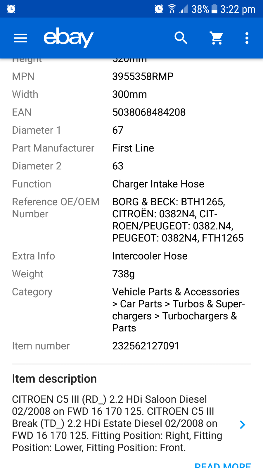

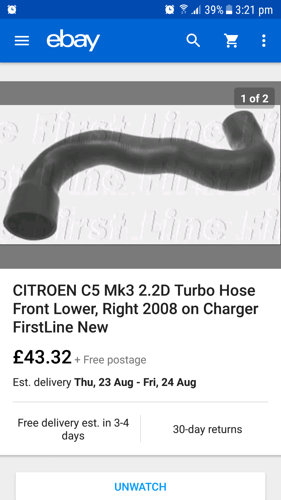

I'm a bit confused now because when I spoke to my local Citroen garage( well a friend that works there) they told me it was this part and gave me this link. Is that not the right part for my car
