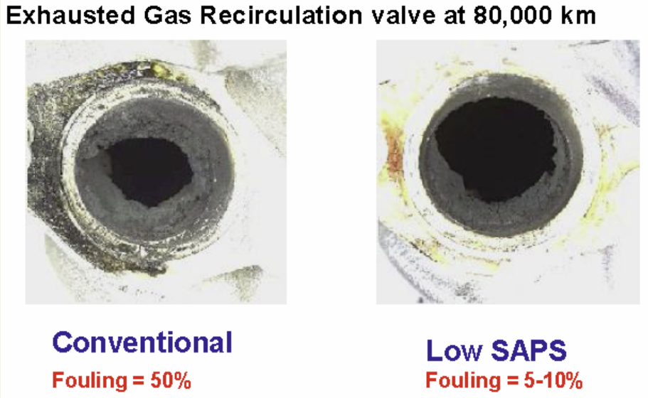

If this is correct, this shows the condition of an EGR valve between a standard and low SAPS oil:
Courtesy of Aussie Frogs / Web

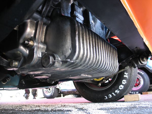

Remember that the Mini/1100/1300 A-series transverse had their drain plugs nicely in the end of the cast sump, at the lowest point, but totally out of the way of grounding...
What better? and that was 1959, the middle of the last century.
