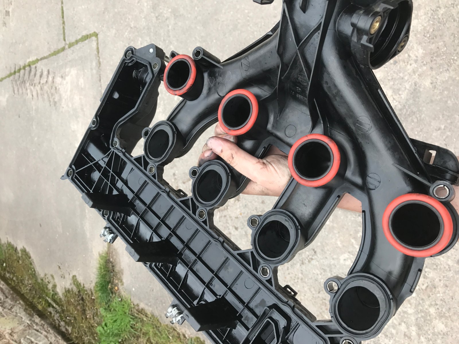

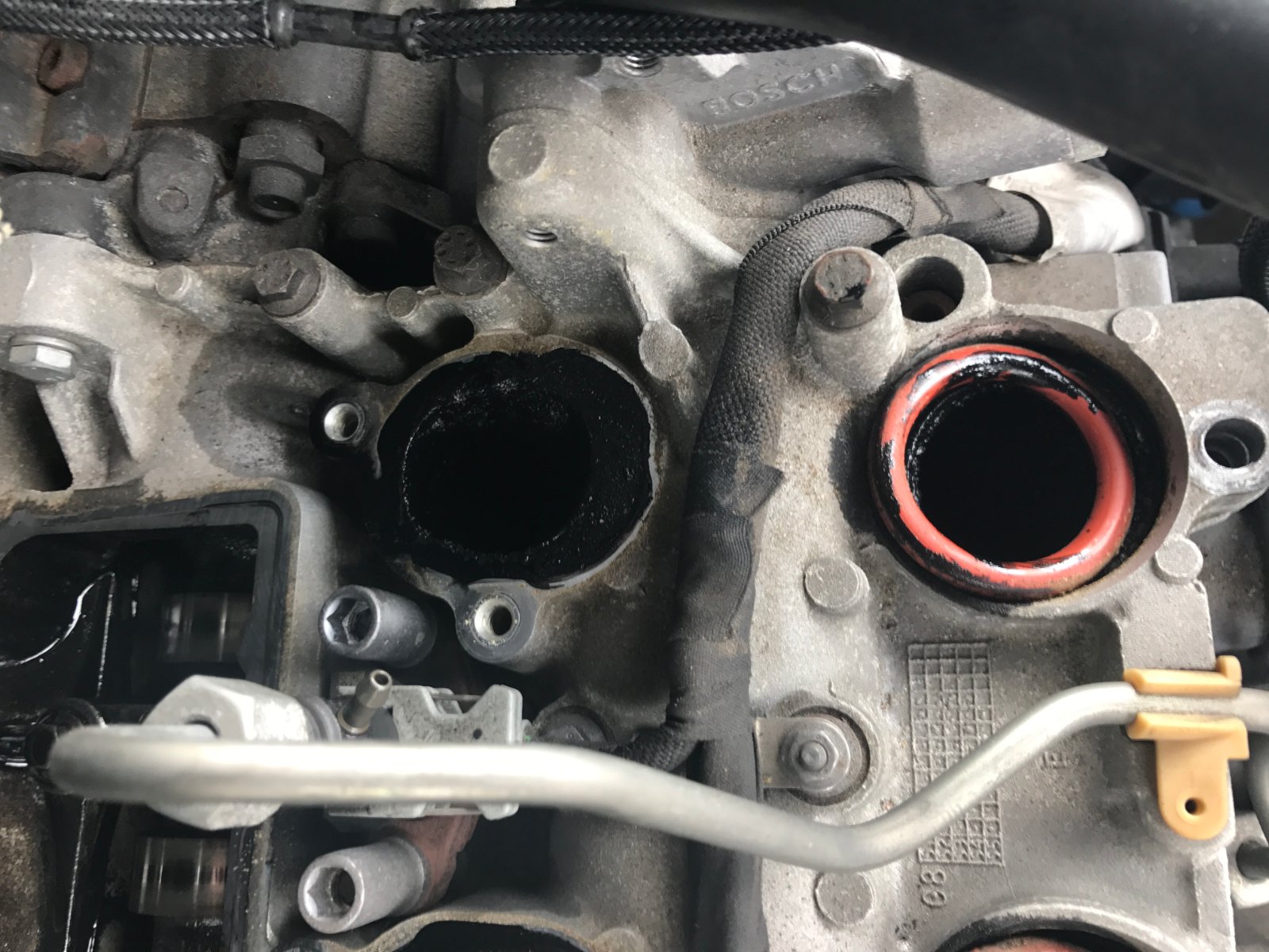

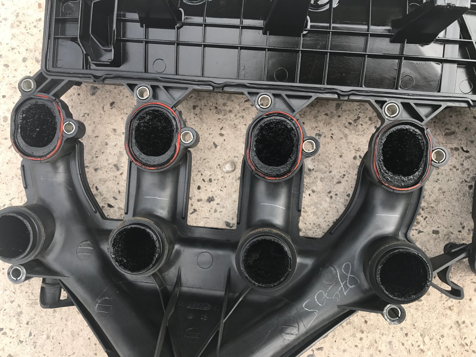

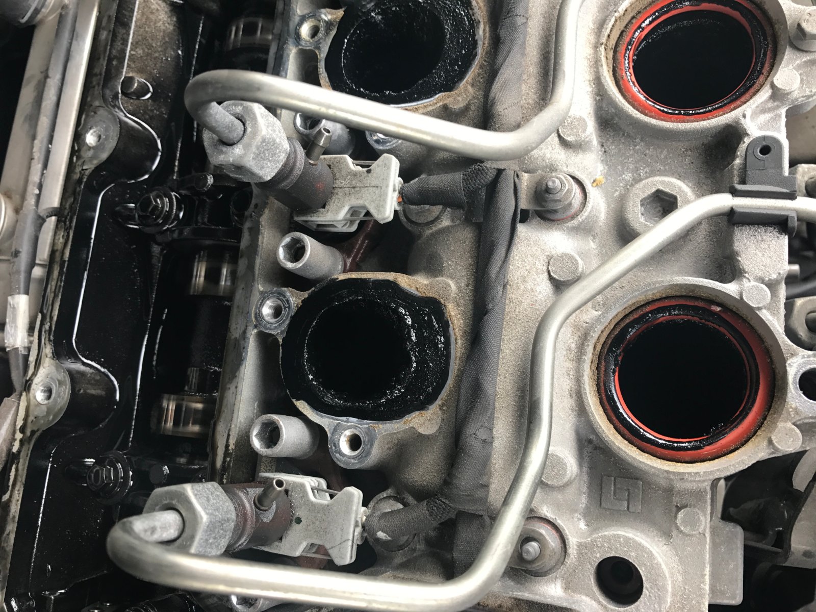

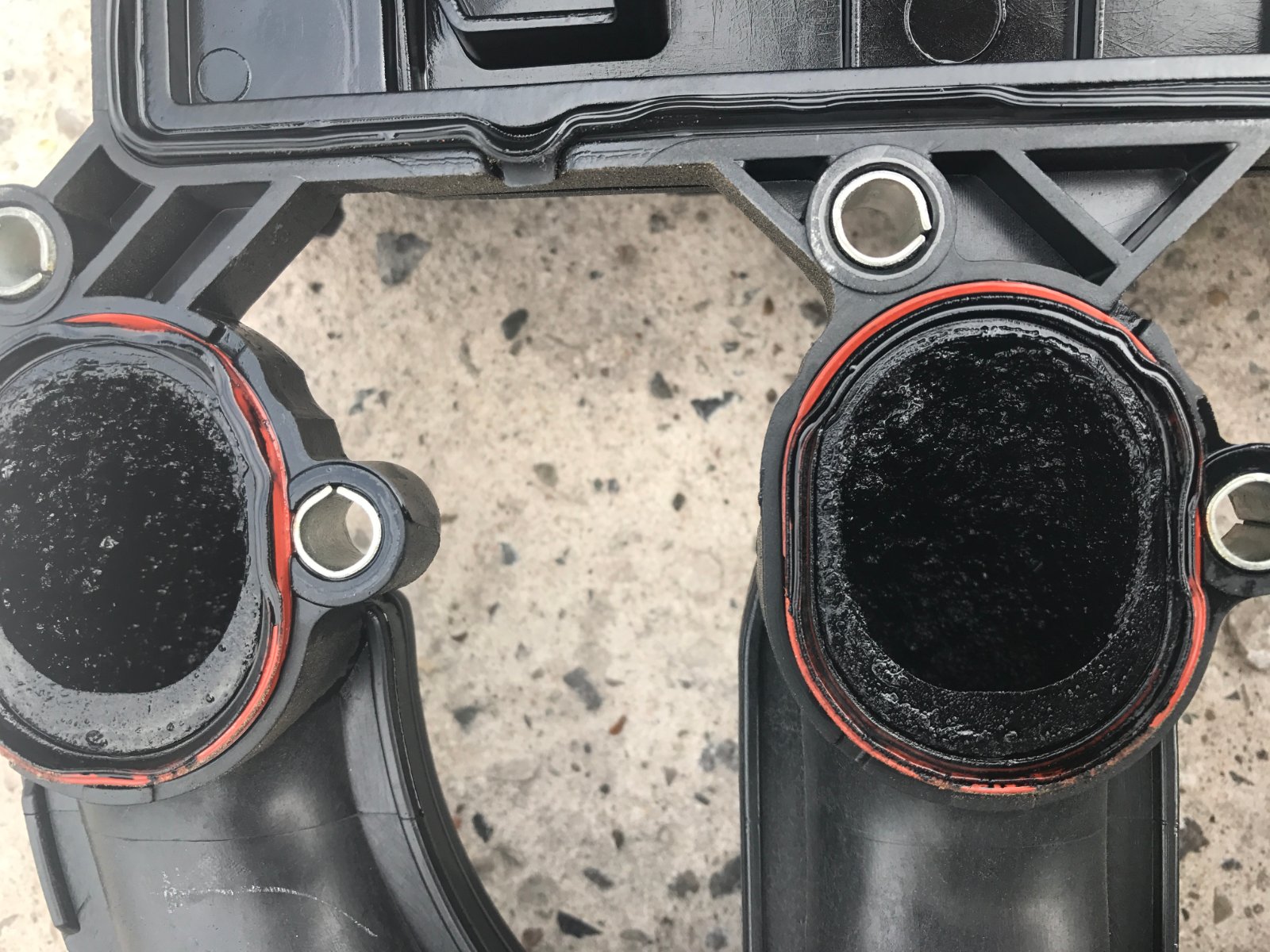

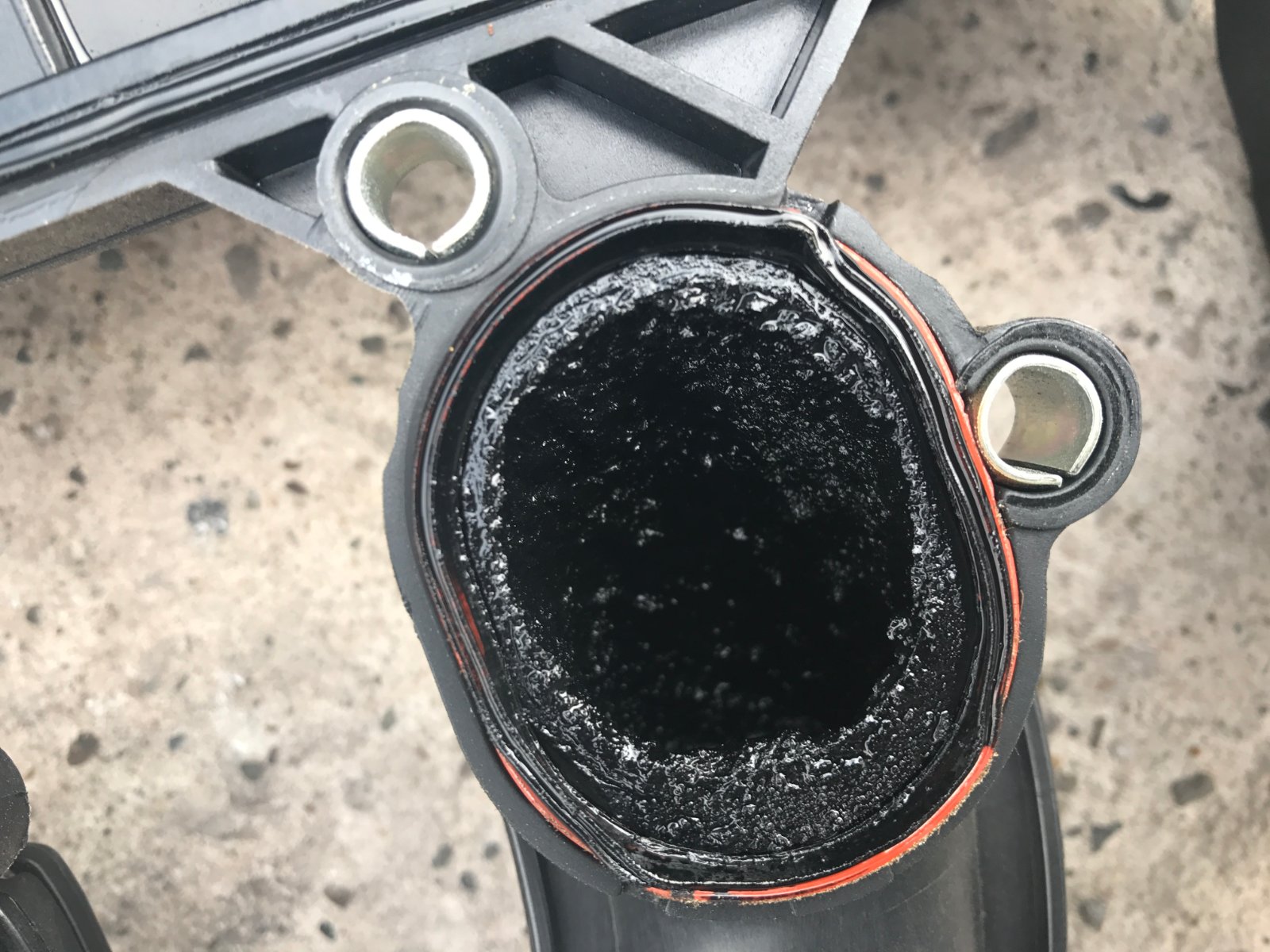

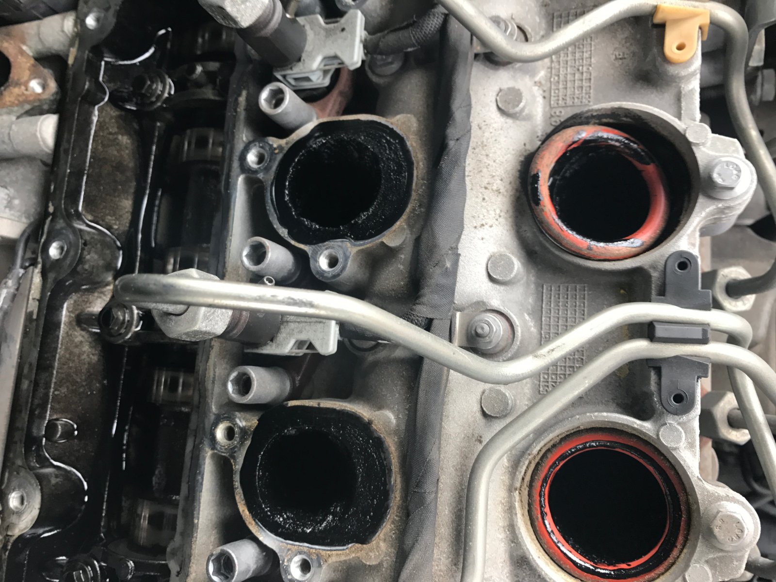

Finally got around to removing the inlet manifold / rocker cover to inspect the sludge buildup.
Overall, not as bad as I feared. Whilst there was a lot of gunk in the manifold, the ports in the head didn't seem too bad, probably only a couple of mm of restriction on the walls.
That said, cleaning the manifold was a horrible job. The carbon sludge had to be scraped out by hand, petrol only helped somewhat as it was that thick that it turned the very thin petrol as thick as motor oil.
I would have liked to have powerwashed it, however, with the oil/air separator being part of the inlet manifold I didn't want to get water in that as it would contaminate the engine oil if not completely dry.
Removing it was a bit fiddly but following the instructions (kindly provided by Marc) I was able to do it within an hour. It requires the removal of the Camshaft position sensor, air doser unit, EGR pipe and crankcase ventilation hoses.
Here are some pictures of what I found.
Below I show how I got to the places I couldn't reach with a toothbrush or my hand. Pulling a petrol soaked rag through every port until no more gunge came through.
All clean, fitted a new set of seals and rocker cover gasket.
Refitting took about 20 mins; a lot quicker as the procedure was still in memory.
After refitting the manifold I took it for a drive to ensure that everything had sealed OK.
I haven't noticed an improvement in performance however I was expecting the gunk buildup to be much worse before starting out so from that point of view I'm not disappointed; at least I know it's clean now.
