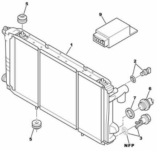

Can you post some details of what engine was in the C15 originally, as this will affect a few things, including the type of radiator there, and its temperature control arrangement. Can you also post the car's VIN number, and RP number (if you can find it).
In particular, do you have a chunky thermo-switch screwed into one of the radiator vertical side tanks? Likely it will have three stout wires connected to it. It's #6 on the diagram...
What this switch does is to sense water temperature in the radiator, and trigger the two fans to run at either low speed or high speed. They do this by operating in either series or parallel, and are switched by a bank of three relays. The circuit is simple and usually reliable (unless corrosion has got in there), and can be tested easily, even without running the engine.
Let's go from there.
