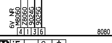

Can you explain where you plugged the 6 pin connector into on the RT4 - I can't see a dedicated 6 pin connector - so I need to know whether you connected it into a separate block for the AUX input or into some of the pins used for the 8 pin connector?
All I can say is that the 6 pin connector on the A/C panel has the following wires:
| 8060 - Compressor control (Earth) Z8060 - Compressor control (Positive) 9024G - Comfort Data High CAN bus 9025G - Comfort data low CAN bus |
