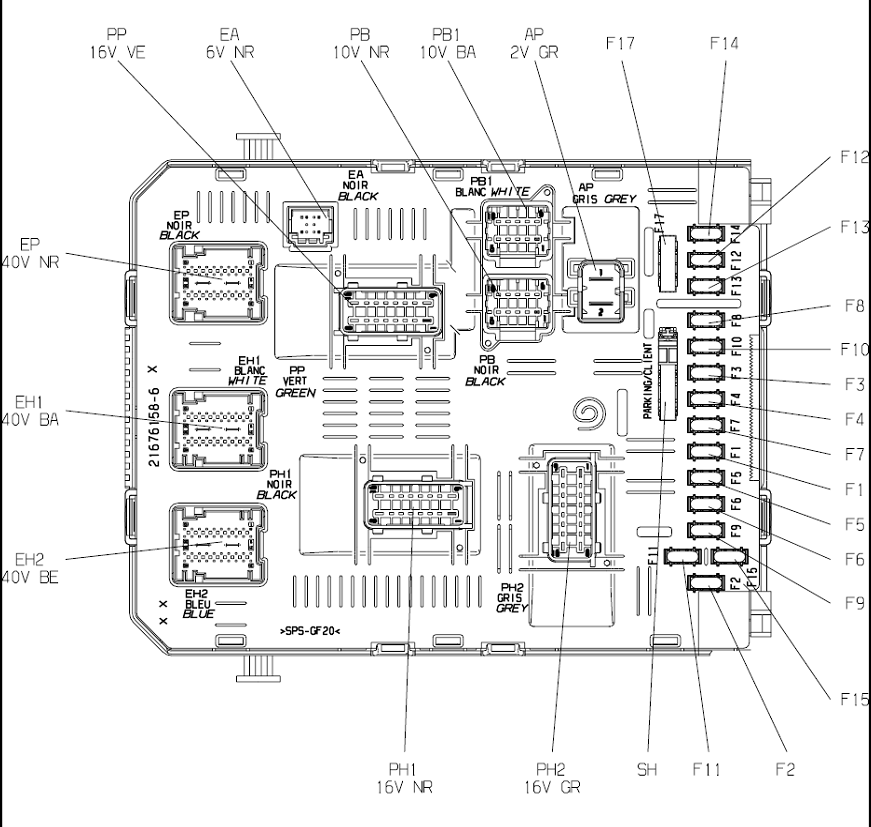

There are some fuses you can check in the BSI module under the driver side stowage panel on a Left Hand Drive car:
Click to Zoom
| Check F4, F12 & F14 |

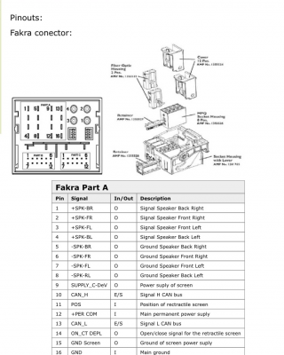

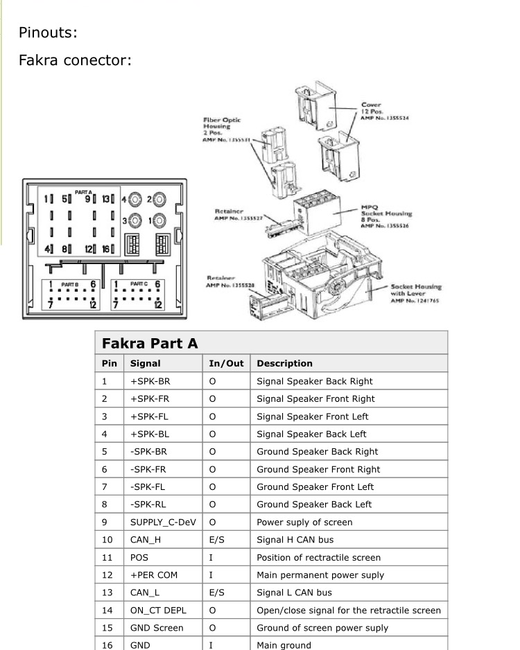

Are you sure you cut the correct (8) wires for the speakers?
Remember the corrector is mirrored in real life compared to the diagram.
Apart from that I'm not sure how you could have caused any CAN related damage without touching the CAN wires.
I think your install is similar to mine except you are using an external speaker to line level converter whereas my amplifier has one built in.
I used an adapter to splice the amplifier in instead of cutting the original wires: viewtopic.php?f=52&t=58078&start=120#p546070

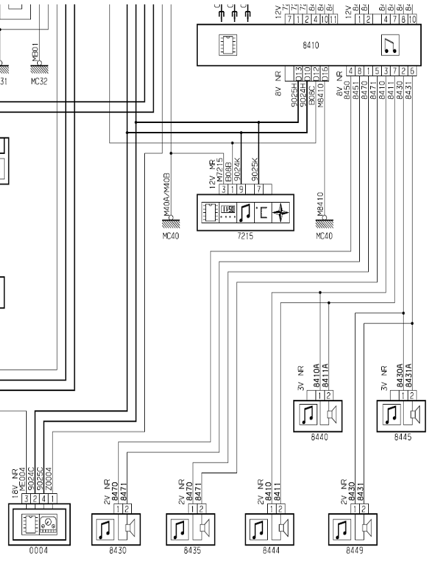

Here's the speaker wiring to the Head Unit to check. The wires may have codes on the sleeves that correspond to the numbers on the diagram:
| Code | Speaker |
| 8430 | rear left loudspeaker |
| 8435 | right hand rear speaker |
| 8444 | front LH woofer speaker |
| 8449 | front RH woofer speaker |
| 8440 | front LH tweeter speaker |
| 8445 | front right tweeter |
| 8410 | RT4 Unit |
| 8V NR | Black 8 Pin Socket |
