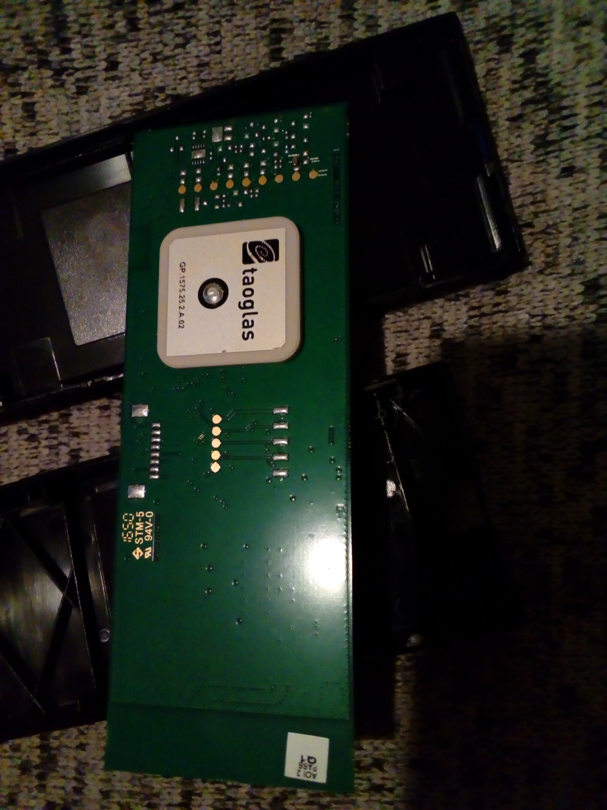

That side panel did come out and I had to disconnect the airbag lock connected to it but no access to top of vent duct unfortunately. Then I got impatient and took a screwdriver to the binnacle surround and off it popped, revealing three torx screws. Popped out the cluster and there it was, sitting all smug and flashing it's LED at me.
Apologies for the wrong orientations
There appears to be a populated sim slot but no obvious removal access and I can't break it open as that'll void the warranty [-X :lol:
I'm glad I got it out, though I was going to pull the fuse anyway.
But I've overdone it today and need some extended rest. I'll dissect the box another time.

A TrackM8 - telematics insurance amongst other things! Well done and good riddance to it.

Good riddance for sure! The manual says it draws 10ma while sleeping so is at least part to blame for flattening the battery.
It also says take care when inserting the sim as it's designed to be extremely difficult to remove. Well perhaps if they'd glued the case it might be but a thin blade between the two halves and it popped open revealing some hardware I'm familiar with. It's worth hacking for hexacopter use.
Again, sorry for misorientation, there's no means of changing it.
