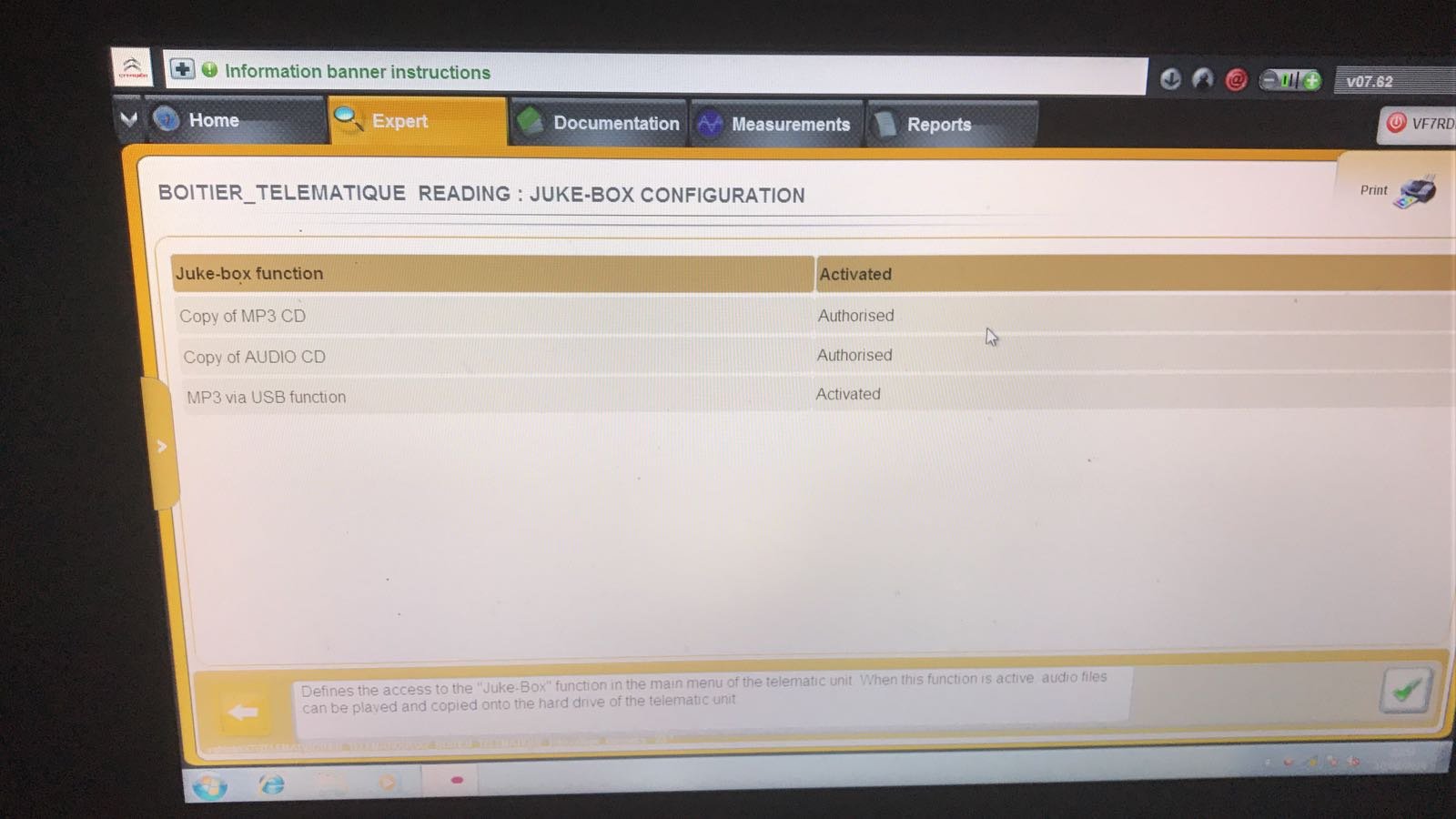

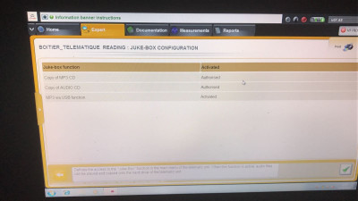

Yeah, you need to enable the USB either through Diagbox or MiraScripts.
If you've got Diagbox, that would probably be easier but make sure you use a new enough version of Diagbox or you may have an issue. After accessing my RT4 with the newest firmware with my much older Diagbox install (7.63, I think) I now have the issue where the RT4 pops a warning at boot every time! I haven't got around to reinstalling the RT4 firmware as it is a pain in the arse.
Just update the RT4 firmware to 8.31 first, and you should be fine using diagbox up to V7.63 for the configuration.
Let me know if you need any more info as I've used bothe methods before.
Here's the section in Diagbox:

Brilliant, Thanks for the Info, all working a treat now, did it with my diagbox as its the v7.83 one.
