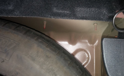

I was sure I was right especially as I have upgraded from just rear to front and rear. As you can see in the photo there are just mounting studs in the spare wheel well on mine, the parking ECU is in the 'rack' along with the other ECU's as mentioned in Marcs earlier post.

That's exactly where it is supposed to be Stu
As you can see from the mounting pins from your pic.
Not sure what happened there, but even Citroen Service for your car show it in the same place as it is supposed to be:
