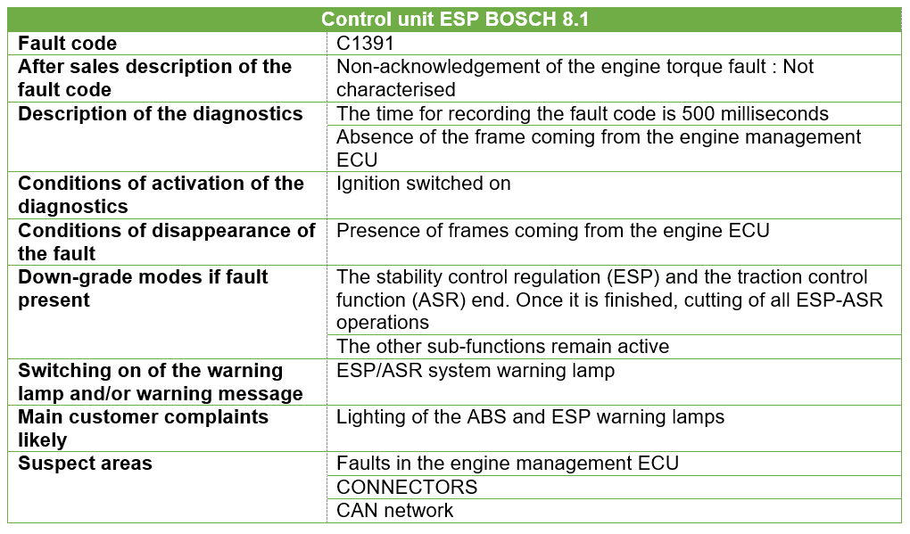

Ok, so for this particular fault, this is what I have in the Diagnostics section. There is no frame data being sent to the ABS / ESP ECU from the engine ECU. So your ESP and ASR functions are disabled as a safety precaution. As you can see the recommendations are to check the connections to the Engine ECU to the ABS ECU and make sure there is nothing obvious that you can see. Other than that, there is little else I can suggest, short of getting it looked at by a competent Auto electrician that has experience with CAN bus multiplexed vehicles.
Click to Zoom the Table

Ok, the speed information can vary if you have different tyre makes / sizes on the same axle or one of the tyres is at a different pressure. These can affect the ESP system, so always make sure you check the tyre pressures and that you have the exact same tyre make and tread pattern on each axle.
