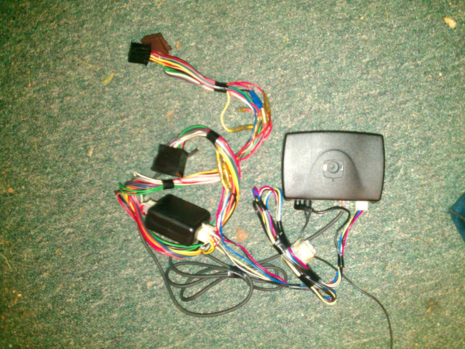

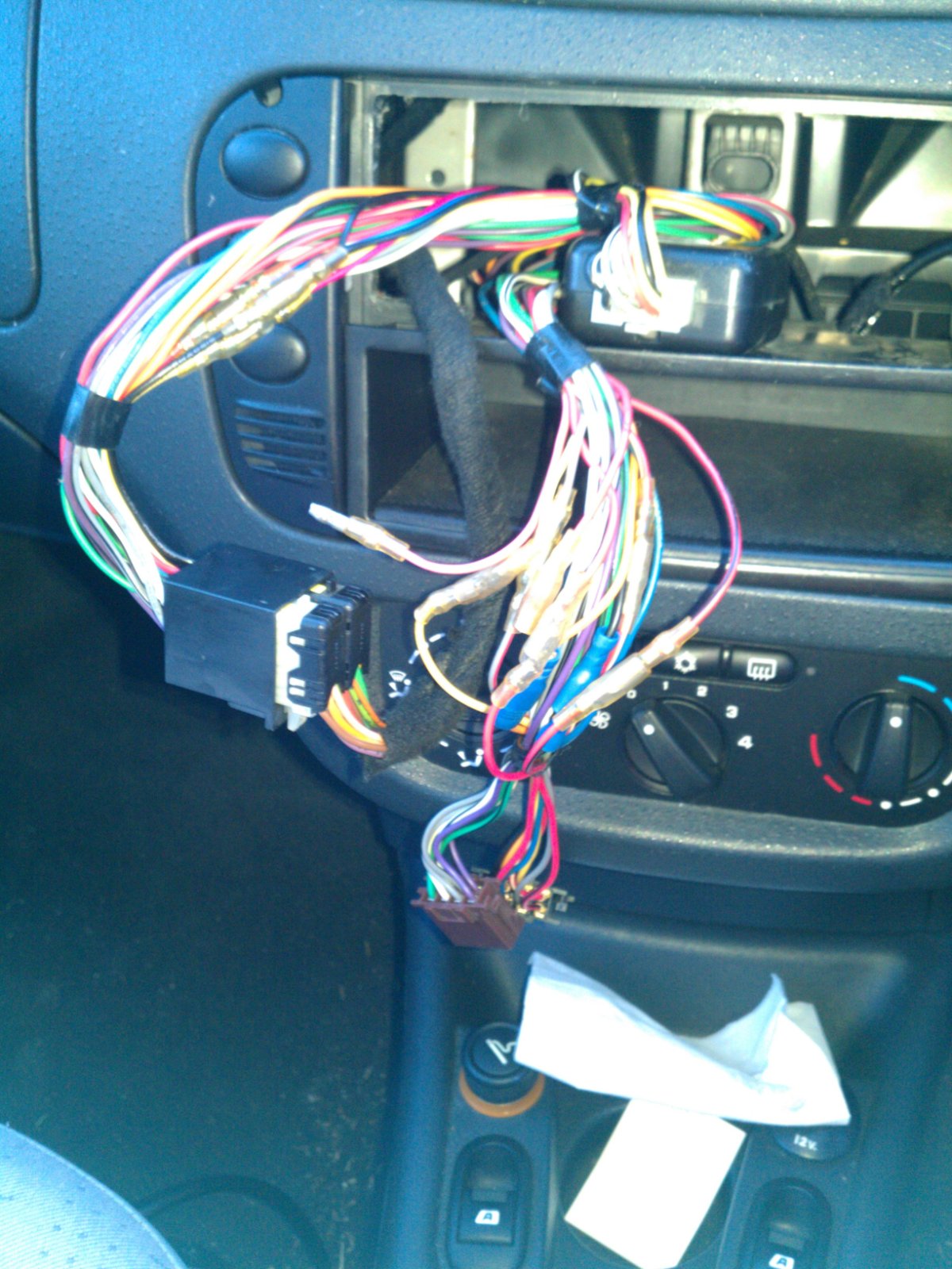

Pulled the radio out and found a nest of wires with a lot of bullet connections (a couple not terminated) and two black boxes.
I think I found the insurance tracker and removed it.

@Mike:- that looks a right spaghetti boloknese in there - what a mess! What are those connectors going into what looks like the radio Quadlock connector? That doesn't look right at all.

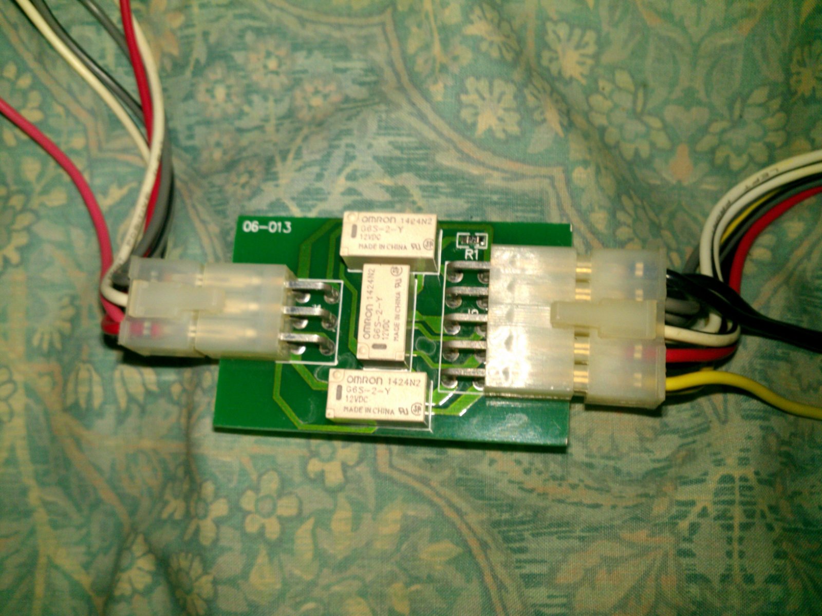

Thats not an insurance black box, thats a handsfree kit (nokia if im not mistaken). The smaller box is a telemute loom to route the telephone calls through the cars own speakers.

The older VAN/CAN C3 uses an ISO connector rather than quadlock type for the radio. It may just look worse than it is in there & quite normal to have unconnected terminals to fit different configurations. They are definitely compatible (if fitted correctly) as i have fitted hundreds of them.
There is a chance it may have gone faulty so best to remove it completely for the time being at least.
All you should be left with is the wiring i have highlighted in yellow.

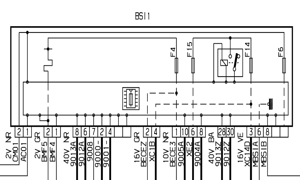

Here are the Audio Connections:
| Code | Colour | Description |
| CV00 | N/A | COMMS Unit |
| BECEZ | Blue | Battery + BSI |
| XC1B | White | Body VAN 1 |
| 9013Z | Mauve | body 1 Van data bus 1 |
| 9012Z | White | body 1 Van data bus 1 |
| MCV0B | Green / Yellow | MC30 earth |
| 6V GR | Grey | 6 Pin Connector |
| 8V NR | Black | 8 Pin Connector |
| 8410 | N/A | Audio Unit |
| 9004E | Red | Comfort Van data bus / |
| 9005E | Green | Comfort Van data bus B |
| XE15D | Brown | Comfort VAN |
| 8454A | Orange | Ampli + switch command |
| BECE2 | Green | BSI + after ignition output |
| M8410 | Green / Yellow | MC34 Earth |
| The BSI where the above connections go |

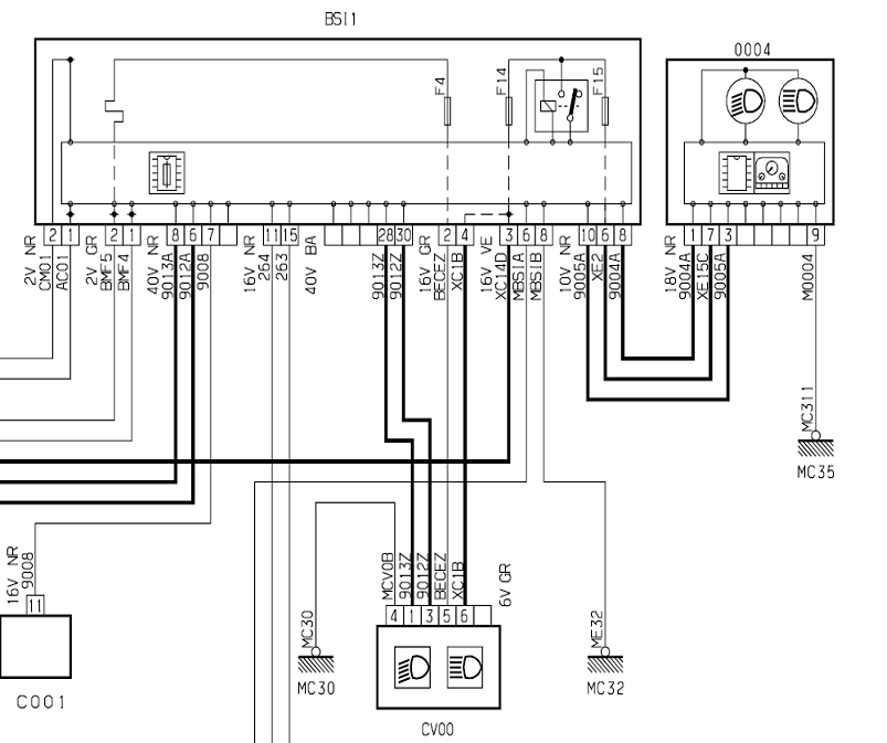

So pin 5 on the grey connetor of the com2000 should be permanent live, pin 4 should be earth & pin 6 should be 12v when the network is awake. Pins 1&2 are the data & data/ wires, you wont get much out them without a scope.
A wiring diagram for the headlamps should give us the rest of the wiring info we need for the time being.

Sorry I was a bit vague yesterday, let me clarify.
As wheeler says, the fitted Clarion RD3 takes what I understand are two ISO connectors (plus antenna), not quadlocks.
The harness looks like a typical ISO adapter harness.
The larger black box, as wheeler has correctly identified, is labelled as a Nokia HFU-5 (hands-free kit).
The speaker and antenna wires were cut and unconnected.
Also connected within the harness is a smaller black box, label illegible so I cracked it open to see what's inside.
Again, I think wheeler has correctly identified it as the "mute" device.

Headlamps Comms Unit: - very similar
| MCV0B | Green / Yellow | MCV00 earth |
| BECEZ | Blue | BSI + after ignition output |
| XC1B | White | 1 body VAN 1 |

Sorry that was a typo, there is no pin 2 on the diagram.
I take it fuse 4 in the BSI is ok & there is a live supply at it ??
