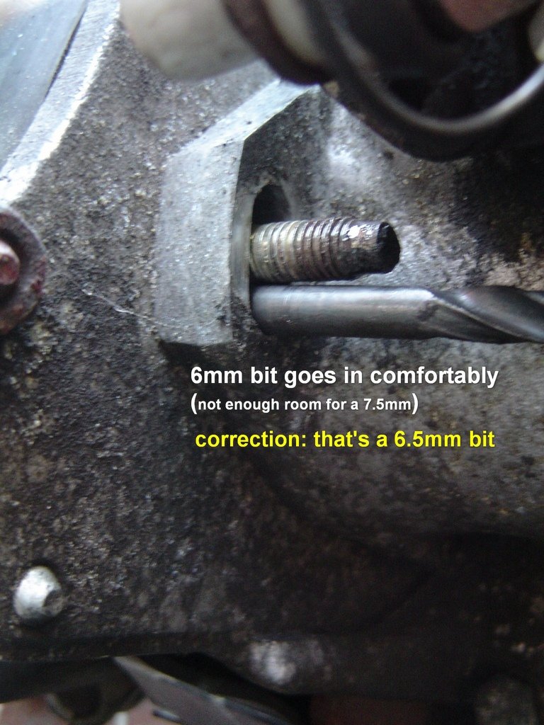

not sure if the Pump Timing will be same between an XUD 1.9na and a 1.9TD, but I've always based my calculations on being able to get a 6.5mm Drill bit beneath the forward lower mounting (the easiest one to reach).

I’ve just rebuilt my Peugeot Boxer 1.9td 2001 engine. Fitted brand new complete cylinder head, 4x new diesel injectors, secondhand EGR valve as I couldn’t source a new one anywhere, bottom end honed out bores and new piston rings and bearings, new intercooler. Anyway fired it up smoked like mad, ( black smoke). So checked all hoses fitted a new air filter, fuel filter. Still no joy. Anyway saw this post and thought I’d adjust the pump timing with the 6.5mm drill under the pump bolt.Definitely and massive improvement.I thought as we are off on a three month road trip I’d book it in a diesel specialist and get it double checked. So I did some research and found a specialist 30 miles away who have really good reviews especially as I don’t have a lot of faith in garages and certainly after working in the motor trade for 20 years. Got it back three days late with a £700 bill. Saying they have removed the fuel pump checked and tested it and had pretty much cured the smoking. Today I did an oil change and noticed the diesel pump had been put back to where it was before I put the 6.5 mm drill in. The smoking doesn’t seem to be a lot better than when I dropped it off. And I certainly don’t think now the diesel pump has been removed and if it has they haven’t fitted anew timing belt ( very worrying) the tell tell time will be this week when it’s Moted with the diesel emissions.
