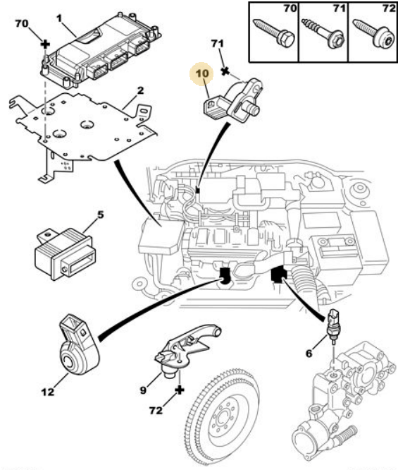

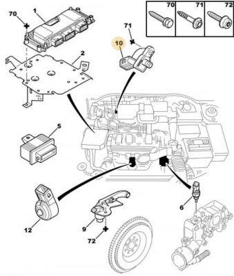

Re: P0107 OBD reading.
Ok, so the correct part number for the Intake Air Pressure Sensor is 9639381480 . An original costs £87.05 from Citroen inc. VAT. to give you an idea. There are used Bosch ones on the bay for about £25 - but I would avoid anything too cheap. Item 10 below:
