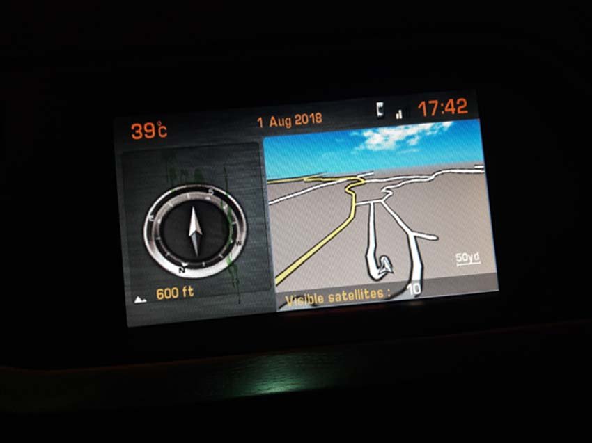

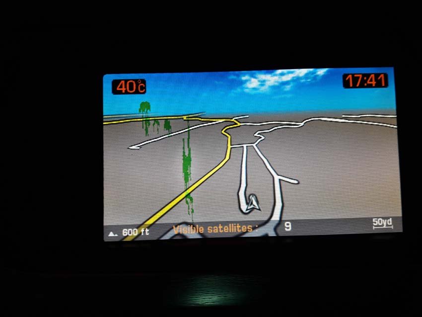

Ok, so my 2009 C5x7 Tourer has sat nav (RT4) and a couple of years ago, after being parked up in French full sun for a few days during a heatwave - even hotter than now - I discovered the display had gone like the photos attached. Just like someone had daubed the screen with green paint, from the inside....
It's never got any worse - even in the 40+ temperatures today inside the car. The effect can be made less obvious by having the smaller map screen, but still a bit disconcerting. Has this happened to anyone else?

That looks like your liquid from the LCD or some of the sealant from the back of the screen had melted at some point.
