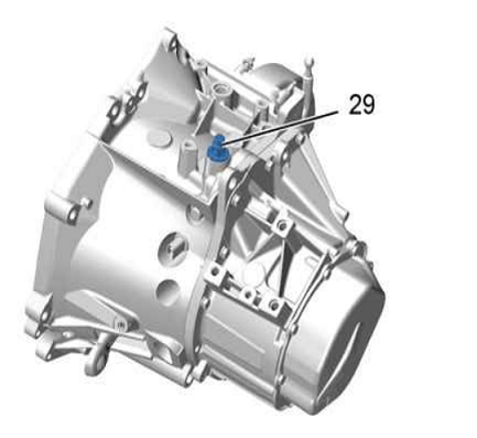

I'm assuming you still have your C5 (X7) 4 DOOR SALOON 1.6 HDi 110 particle emission filter (DV6TED4) Manual gearbox 5? If so, there is no visual check of the oil level for these boxes, as they are supposedly 'sealed for life'.
You have the BE4/5L and it uses the ESSO 75W80 EZL 848 or TOTAL 75W80 H 6965 oil.
The oil capacity gearbox from empty is: 1,9 ± 0,15 litres.
The oil is filled through the air vent hole (29):

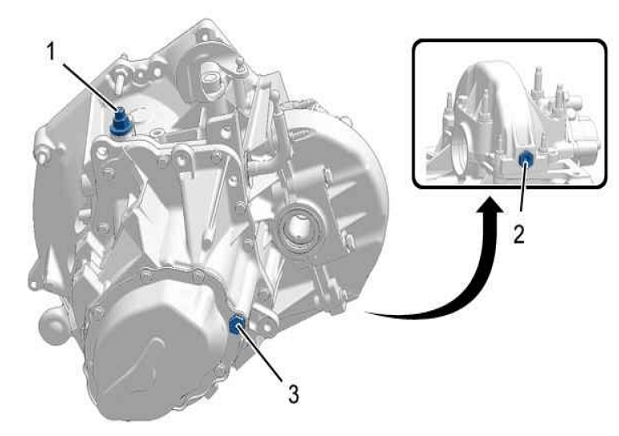

If you are feeling adventurous and want to give it a go:
3. Drain and refill
CAUTION: It is necessary to drain the gearbox and put back the exact quantity of oil, in the event of an external leak or a repair.
CAUTION: Adhere to the tightening torques:
Vent Hole: 1,5 daNm, Level Plug: 2,2 daNm, Drain Plug: 3,5 2,2 daNm
Engine flywheel retaining pin (2).
Remove:
Refill the gearbox either via the vent hole (1) or the top-up hole (3); Using tool [0344].
Refit:
| (1) Vent hole. (2) drain plug. (3) Oil level plug (According to gearbox). | Tool 0334 For Refilling |
- Remove the under engine protection.
- Remove the cap (2) to perform the draining.
- Gearbox empty : 1,9 litre.
- After draining : 1,8 litre
Remove:
- The service battery (depending on the engine)
- The battery tray (depending on the engine)
- The air filter casing (depending on the engine)
- The vent hole (1) or the oil level plug (3) (According to gearbox)
Refit:
- The air filter box (depending on the engine)
- The protective panel under the engine
