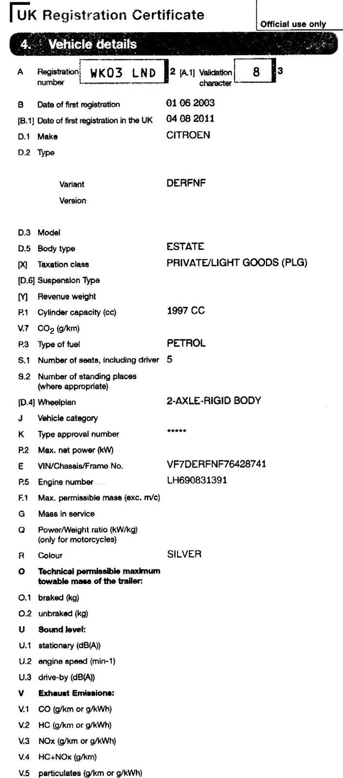

I am having a lot of trouble locating the correct catalytic converter for my C5.
Citroen Mk1 2003
WK03 LND
Petrol Auto Estate
VIN VF7**************[VIN obfuscated, can be read by forum staff]
RPO 09654
Engine Number LH690831391
Engine Code EW10J4
2.0 16V 1997ccm 136 HP 100KW
The car was first registered in France in 2003 then in the UK in 2011.
Why I have no idea, it is RH drive though there is a service record of the speedometer being changed to a MPH version : )
Please attached images from log book.
This is causing problems with suppliers as the reg number does not resolve the information they require, as below : -

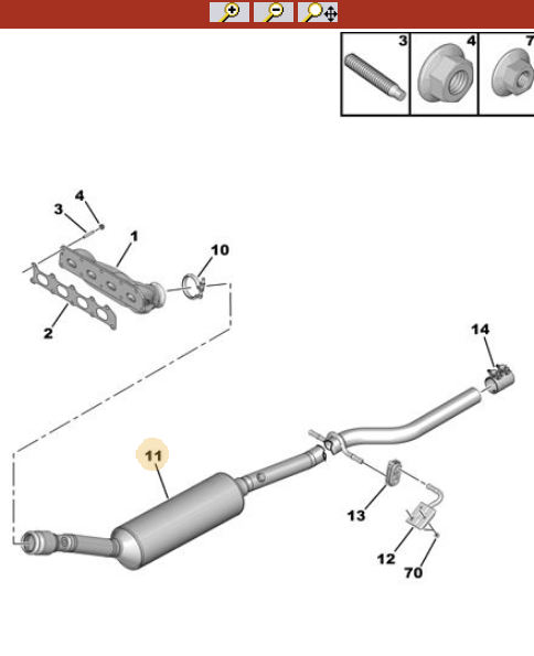

Hi Spiff
Ok, so the part you want is the PIPE FRONT EXHAUST TO CATALYST as shown here no 11 on the diagram:
The Citroen Part number is: 170673. The replacement part number is: 9805858780
It's always worth using the proper Citroen Part number - I never use the reg as a lot of supplier databases are just not up to par.
A lot of places are out of stock Spiff - but I have located one company in Europe that ship to the UK for £298.69 inc VAT. Links:
Main Link , then it is the top item which I have also linked below:
Specific Catalytic Converter
When you consider the main dealer prices below for both the original and replacement part are between £1,000 - £3,000, it 's a bargain!
There are a couple of shipping options if you need it sooner though.

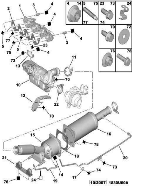

- x 6954
Re: Can anyone assist please part number or OEM for catalytic converter
They tend to show the various parts and how they all fit together - so for your VIN, the three sections for the exhaust system are:
Hopefully this shows how it all fits together and the various parts

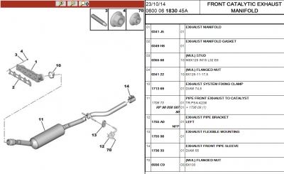

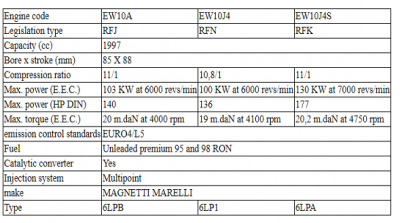

I see Spiff - So the question remains then as to whether your VIN is not providing the correct info? I see that your model on Citroen Service is reported as a C5 5 DOOR ESTATE 2.0 i 16v 138 4-SPEED AUTOMATIC GEARBOX - which of course is impossible as there are no petrol 138, only a diesel 138......
There is however a 136 as you can see in the diagram below (Your engine code is an EW10J4 RFN according to the VIN)
So maybe this is something worth checking out with the dealer and see if they can throw any light on things?

- x 6954
I'm no expert on the petrol ones Spiff - but the Diesel engines have both a catalytic converter then a particulate filter as seen here:
(15) being the cat and (16) the DPF But as far as I know for a petrol Cat, all the components are inside the converter itself...

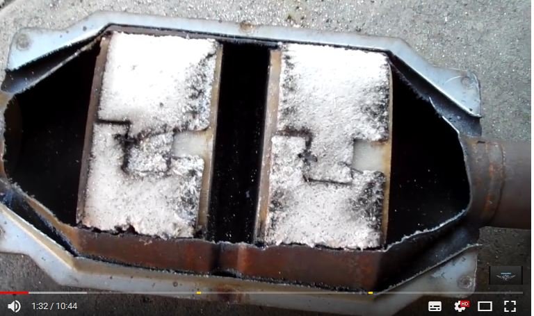

Hallo Marc,
This is a good you tube video very watchable.
Just ignore the joke at the start which he apologises for : )
a nice gentleman who knows his cats : )
Also still image attached from video which shows the two parts of a petrol cat.
God Bless Spiff
Added : ) The reduction and oxidation catalysts are typically contained in a common housing, however in some instances they may be housed separately.
God Bless Spiff

Good luck with it Spiff. I note that they specify that is a for an HPi engine.... and can’t see reference to that myself, but if it fits great!
Also another interesting thing about your car. I have just been pouring over the specs from the VIN and notice that the radio frequency was set at the factory to ASIA. That tells me that the car was originally exported / destined for the Asian market and was probably reimported back at some time...
- Posts: 10911
- Joined: 09 Nov 2005, 22:03
- x 1438
GiveMeABreak wrote: 03 Jul 2018, 08:20 Good luck with it Spiff. I note that they specify that is a for an HPi engine.... and can’t see reference to that myself, but if it fits great!
The car may never have made the trip to asia, it might have been ordered to export specifications with local delivery (e.g. tourist delivery), with the first owner ultimately deciding not to take it home. It is also possible that it was a sample car that was made to export spec, but for some reason the factory on-sold it locally.
Note that with regard to the radio spec, "Asia" just seems to signify ITU region 2, which includes Australia and New Zealand, both of which mandate metric speedometers.
