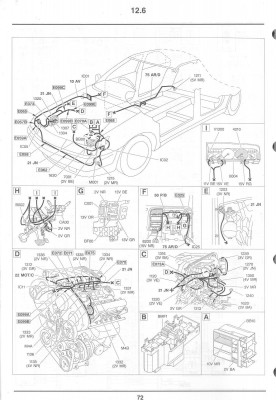

i want another pages of this manual
i have just 2 page of this manual
thank you all for replying
