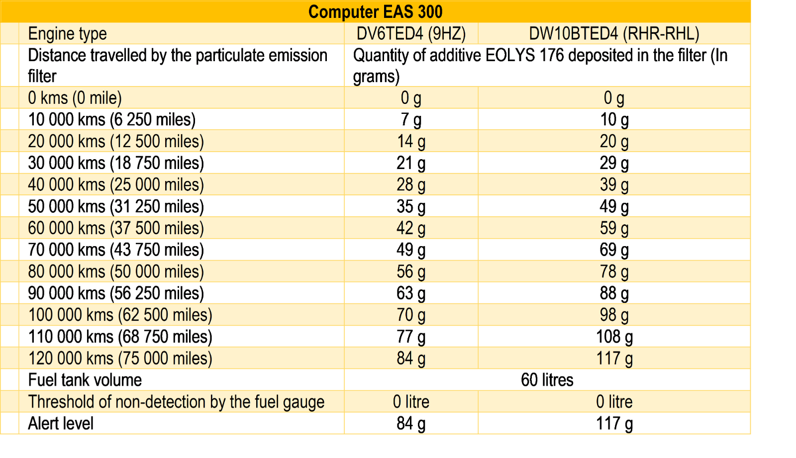

75k miles is actually the alert limit for this system, as can be seen from the table below using the third column for the DW10BTED4 engine on this vehicle.:
Click on images / tables to zoom The vehicle is also Euro Standard 4.

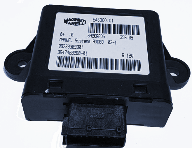

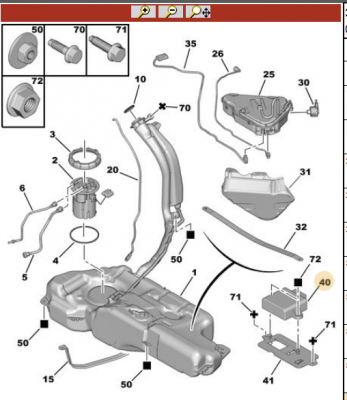

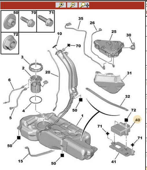

There is also another thing you can check - as this model C4 (not Picasso) has a separate additive ECU. There can be communication problems caused by one of the fuses that controls both the diagnostic and the additive ECU. It is fuse F11 located in the BSI fuse box as I described earlier - glovebox area, and marked in green below. Although the fuse may appear ok, replacing it with a new one will eliminate this as a suspect and has been successful with others. As others have found, these type of fuses can suffer 'fatigue' and become prone to intermittent operation.
This is the Additive controller unit EAS 300 (ADDGO). But I can't say for sure where this is located on the C4 Saloon.

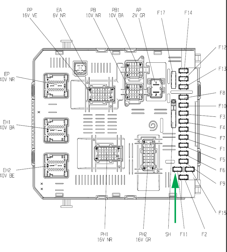

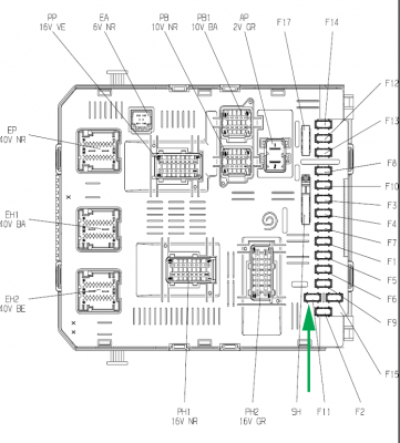

Re: '05 85K mile C4 2.0HDI Lexia 3 advice please
I have the same engine (albeit with some mods for later Euro approval), and the same Siemens Engine ECU - but on my C5 X7, there is no separate Additive ECU - it is controlled by the Injection ECU, but on yours you have the separate module that I showed an image of in my last post. So I believe you need to have communication with it in order to reset the counter back to zero.
And for the price of a fuse, I would really suggest replacing it to eliminate doubt about that as the issue Ken.
Update
I changed F11 and F4 (for good measure seeing as it is associated with the additive system). Both fuses looked fine and showed zero resistance across them.
My old C4 Docbackup 2008 saved printouts indicated that the additive ECU was located behind the BSI and so the glovebox was removed (with difficulty seeing as Citroen had helpfully hidden the final fixing screw behind the airbag warning label !!). Only the ECU connector can be seen/accessed easily and not fancying BSI removal I simply inspected the contacts and 'exercised' the plug in and out a few times.
After a struggle to get Lexia to connect to to the car (always seems to require a great deal of wiggling of the diagnostic plug to get proper contact) the Global test showed dialogue with the additive ECU (hooray!) but not with the additive pump. Anyhow this meant that I was able to reset both counters to zero. Strictly speaking I should also replace my FAP but I believe it still has a way to go. The indicated pressure drop across it is low.
The depollution system faulty message has cleared.
Many thanks Marc and Richard for your advice - much appreciated.
Ken
