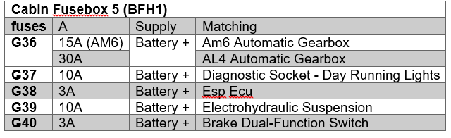

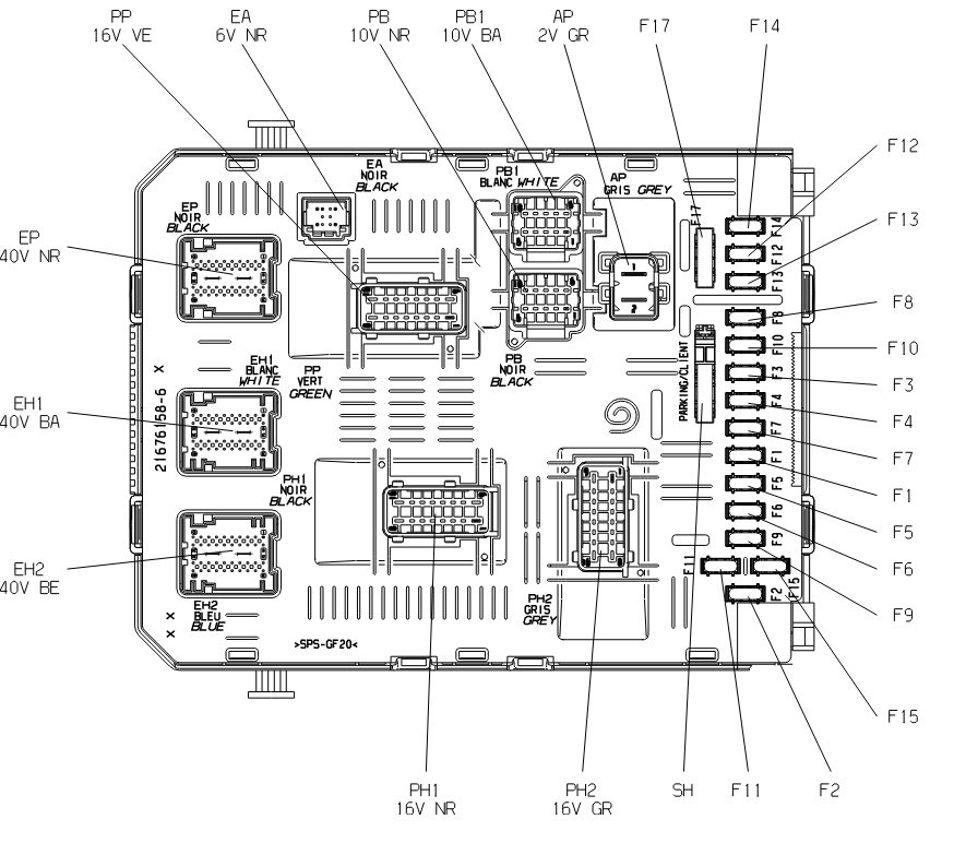

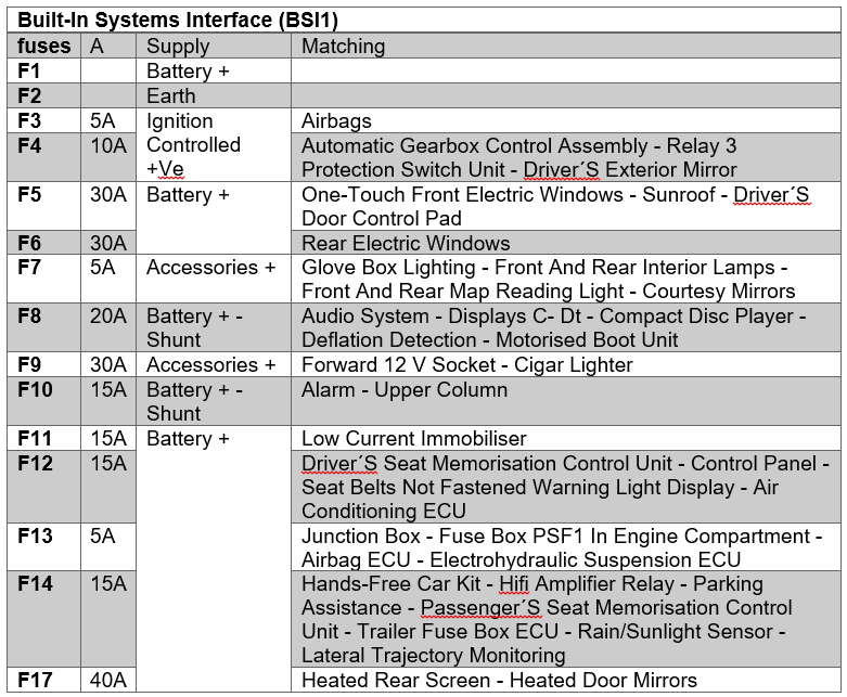

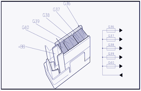

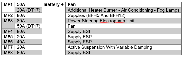

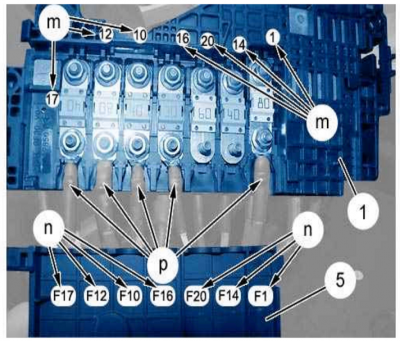

For reference, these are all the ones that I can find that reference the suspension system:
Maxi Fuses
Note - only the V6 models have a 20A (MF7)fuse here for their suspension - not on the 4 cylinder variants) - just included here for reference.

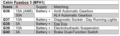

Cabin Fuse G39:

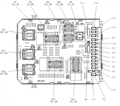

BSI Fuses
Note F13
Maxi Fuses
Note F13

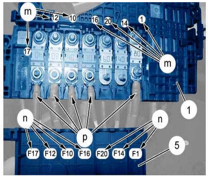

This is off an X7 - but you won't have one, the MF7 is only for the V6 (see my note above the table) I just put these up for future reference to cover all the X7 models.
These are them on an X7:
