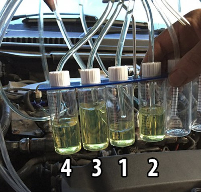

Both my 2.0 c5 and my 2.2 2004 boxer camper cut out under load.
Both times an injector was faulty.
A leak off test for your friend it is almost free and may take about one hour .. take before and after pics for all ?

And further to what John has said ^ did you get it diagnosed with Lexia? Those codes are key to what is going on - and if a Lexia is used they should be able to get some live readings from the injection system / injectors. That and any codes will help - replacing parts at random won't though I'm afraid.

I second a faulty injector, a leak off test will show a dodgy injector a mile away.

Just 4 empty plastic bottles and some tube
proper Blue Peter stuff ..
- Posts: 28670
- x 5671
Re: 2004 Relay / Boxer cutting out
There are youtube videos showing the procedure.jgra1 wrote: 13 Jun 2018, 22:34 Just 4 empty plastic bottles and some tubeproper Blue Peter stuff ..
Just one example.

I caught up with my brother in law yesterday. The final diagnosis was 2 faulty injectors. After replacing those, normal service has been resumed.
Looks like the "specialist diesel mechanic" he took it to wasn't the best, as he only did a leak-off test after replacing other parts first; if that had been step one, it woudl have been a much quicker and cheaper experience.
