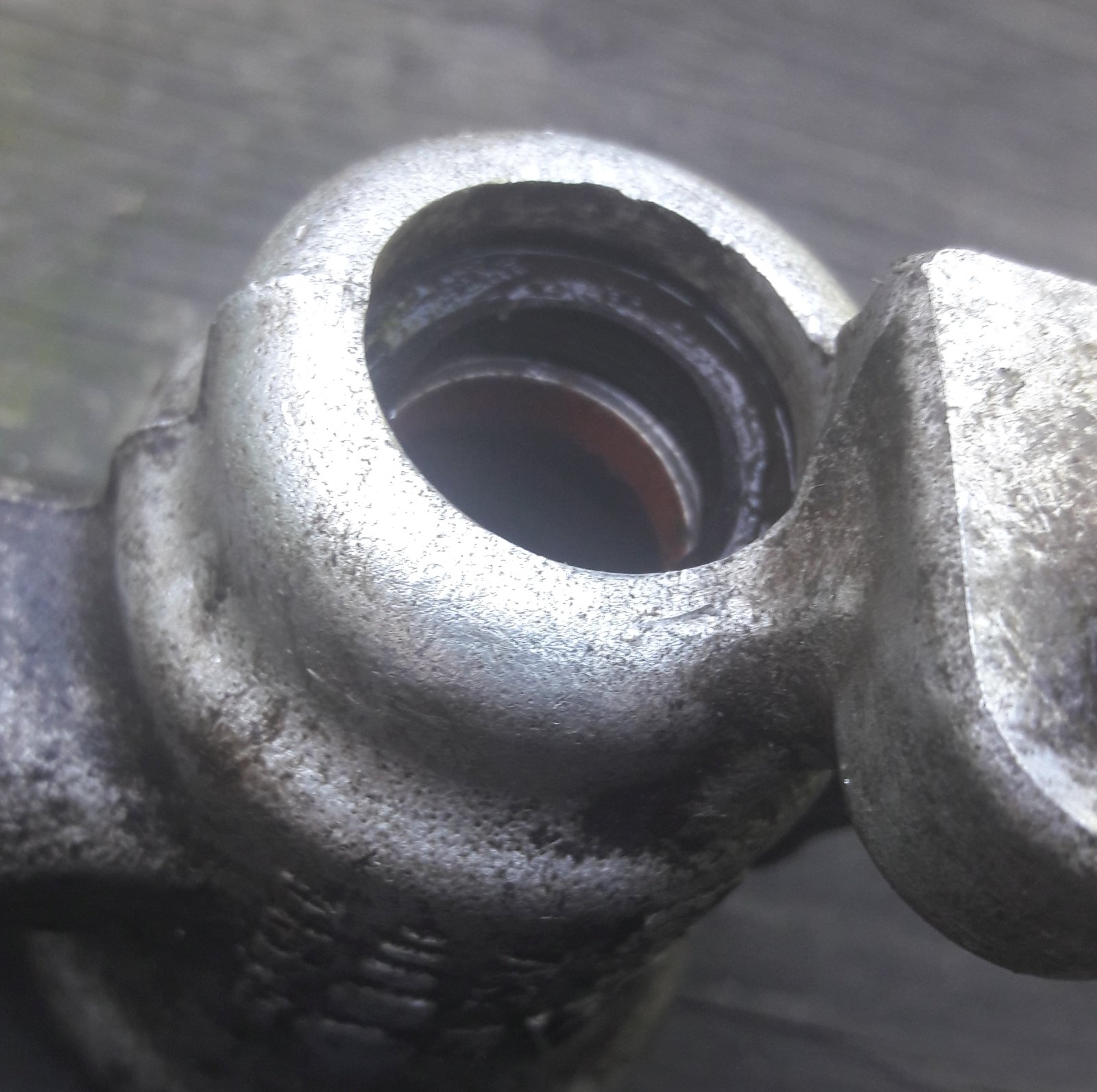

Looking at that, I am fairly sure that the seal comes out and goes in from the top, no need to disturb the bearing (and maybe no need to dismantle the rack).bobins wrote: 11 Jun 2018, 19:34 I couldn't resist any longer - so I set about taking my old spare leaking rack apart to see what I could see. And the result is... inconclusive.

'fraid not
there's a 2-3mm lip on the casting and the seal sits under that. If it wasd a flexible seal then it'd be possible to put it in from the top, but it's a classic rigid oil seal so can't be persuaded into place from the top
I've got the housing sitting next to me here so if anyone wants better photos then I'll dig out the grown up camera and take some better shots.

Re: C5 X7 Steering Rack - Again!
OK, assuming that it is a steel bearing in an aluminium housing, it should be easy to remove the bearing by heating the assembly to about 150 degrees C and let differential expansion do the work.
That lug is a pain in the backside being there.........is it a solid lump ?
I see that lump as the ideal fixing point for a gator...I have a plan forming in my little bit of grey matter.
Yep - a solid lump, but with a drilling all the way through to take the stud.
As an additional note, the top of the casting is only just parallel to the sides i.e. it'd be a little bit of a pain to get a positive fix of some form of cover onto the casting and use something like a jubilee clip to hold it on - the more you tightened the jubilee clip, the more the whole lot would want to slip off the top of the casting.
Looking at several of the photos of the lump and the pinion casting, I wonder whether it might be possible to just slice off the outboard end of the lump - by a 'vertical' sawcut made parallel to the pinion shaft - so a modest diameter gaiter can be slid over the remains of the lump, and properly clamped on to the curved 'waist' below the lump.
Some more photos of the lump and its environs, from all angles, would help.
I see no advantage at all in not greasing the pinion shaft, and encasing it in a properly sealed gaiter. If weather can't get in, there will be no rusting. The part of the pinion shaft below the seal (inside the rack) is made, presumably, of the same steel, and that doesn't rust. (I'm amazed that a chunk of steel capable of being worm-cut, and presumably case-hardened, can suffer such appalling and destructive corrosion.)
