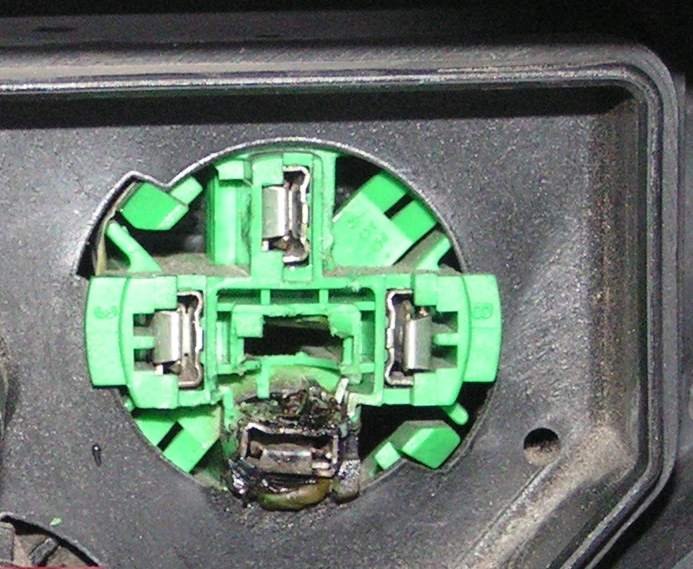

Is there a way to determine whether it functions right? from what I've seen on the wiring diagram, I guess that my problem is that the low speed doesn't work at all and when the coolant reaches the point that the system has to change from low speed (series connection of the fan motors) to the high speed state (motors connected in parallel) only one (the left motor, according to the picture) works at full speed. now, since I know that the right motor works as well when the A/C is on, I guess that the problem might be with the relays or the bitron, as you call it.

From what I remember that’s a faulty top right relay or socket.

To start with, just pull all three relays (one at a time, just in case they're not identical*) and inspect the base contacts for dirt, damage or corrosion, as well as the relay sockets. Are those pix above of atr's car?
The relays are handling considerable current, and a poor contact can cause burning of the contact and/or melting of insulation etc. All three relays must function properly for the two fans to work correctly at the two speeds.
* Usually all are the same: 5-pin, with the same numbered pins. Standard automotive type, 12v 30/40A, single pole changeover (SPCO). Obtainable from any motor factor or electronics supplier.

No, they're from my bucket ... photobucket.com/Clogzz ... over 10 years old.Are those pix above of atr's car ?
Swapping the top left relay to the right should indicate where the fault is.
The top right relay does the low speed for both fans, and a missing top left relay will only cause one fan to stay still when the other one spins at high speed.
So … the low speed should work even with the top left relay taken out.
Only the lower centre relay needs 5 pins, the two top ones get by with 4 pins.
