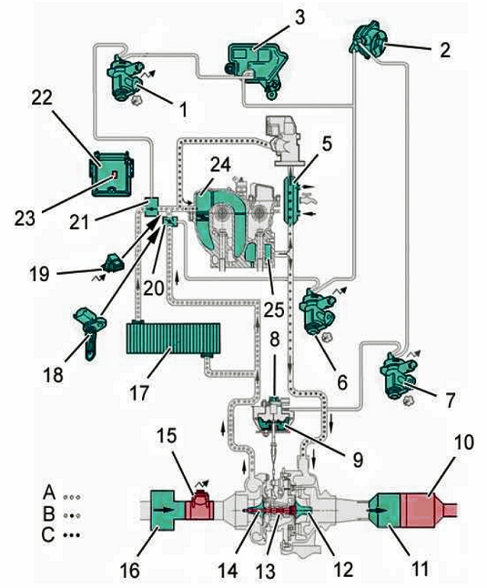

Marc,
Can you post up a diagram of the boost control valve and the associated plumbing, especially the hose (if any) to the atmosphere port?
- x 6956
Re: C5 Mk2 2.0 HDi fuel tank gives pollution error

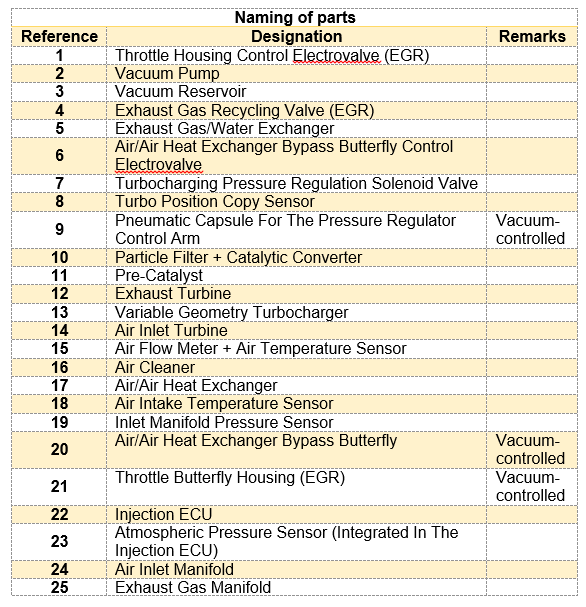

This is for the Siemens System fitted to this vehicle. Number (9) is the Pneumatic capsule.
Click to Zoom
Click to Zoom
| Air circulation (as per arrows): A: Outside air intake B: Exhaust gas + Air C: Exhaust gas | Legend |

That diagram does not show the atmospheric hose to the boost control valve, but I think that there is one (1622z3)
check that the little filter on the end is not restricting the airflow through this hose, it it is, it will cause control tracking errors because the control valve will be unable to dump pressure fast enough.
