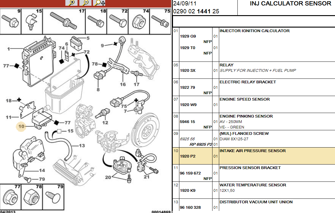

I have a 1995 Xantia 2.0i which is returning lamentable fuel figures, my garage guru says change the Map sensor, but there seem to be several different versions available.
Can anyone oblige me with a part number please?

Please always quote or PM a VIN to us when asking for part numbers - it saves us having to search through your posts to find it - it is not one size fits all.
If your VIN on this Xantia ends in '8087' then it is Part number (10) in the diagram, 1920P2. It shows as still available from Citroen and costs new £108.82.

Thanks Marc,
It's been a long time since I've posted - clean forgot about the VIN - Sooorry.
You got it in one and thanks for the helpful leads, always happy to save money.
I think it's a tribute to the car and my Thai mechanic that you heven't heard from me in such a long time!
I'll get on and order one right now...................
