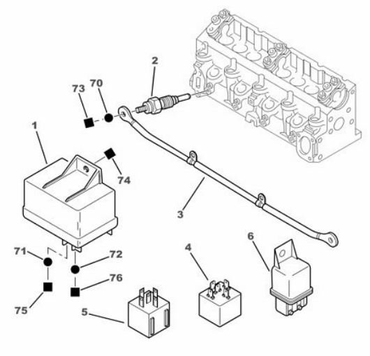

- x 1751
Re: Cold start chug chuggery Xantia td
For testing the GPs individually after removal, don't worry about polarity (+ and -) on the glowplugs ... it doesn't matter.
They usually consume about 11amp each, iirc. GP relay is #1 in the diagram.
Disconnect the battery before removing it.
