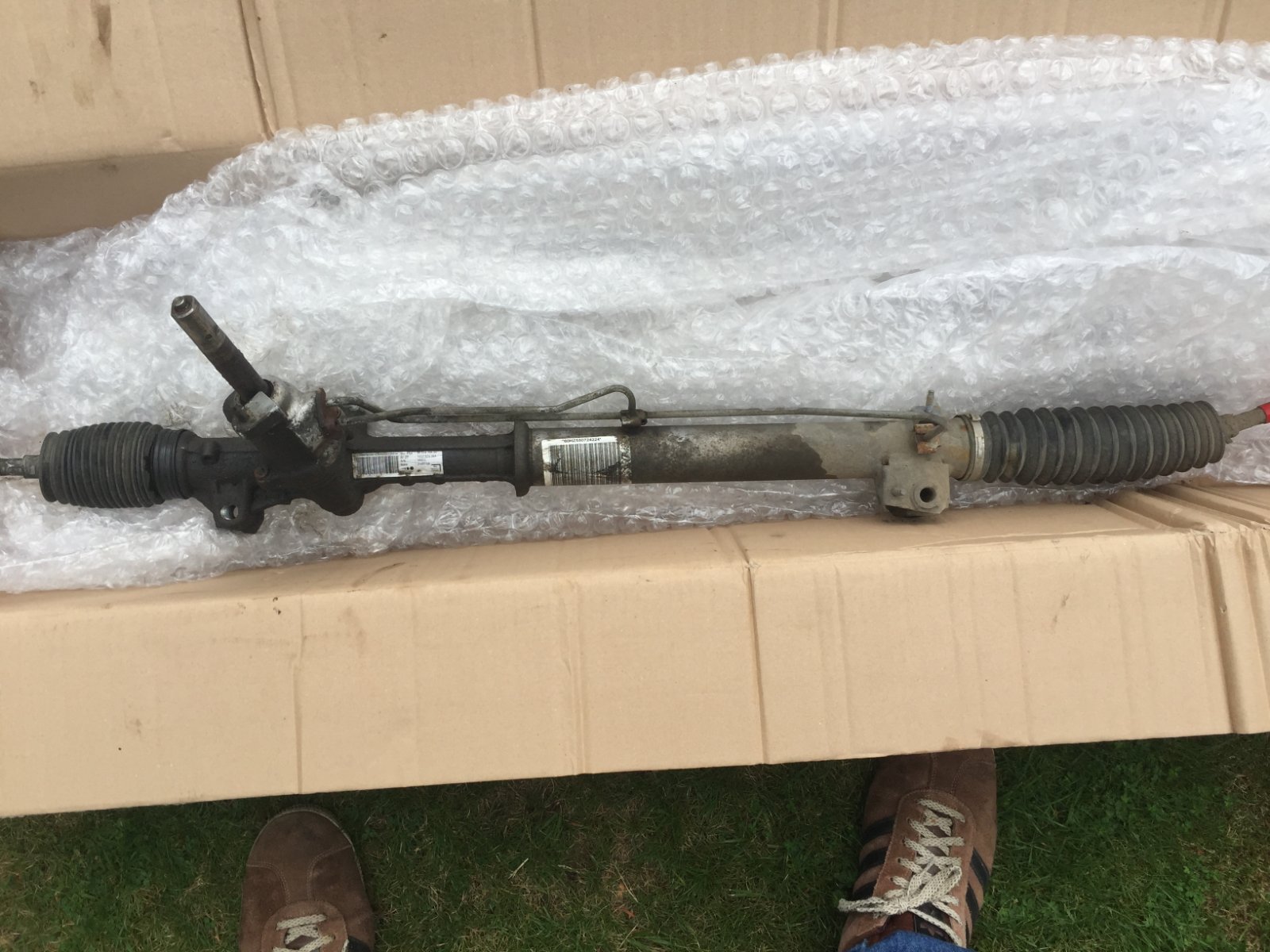

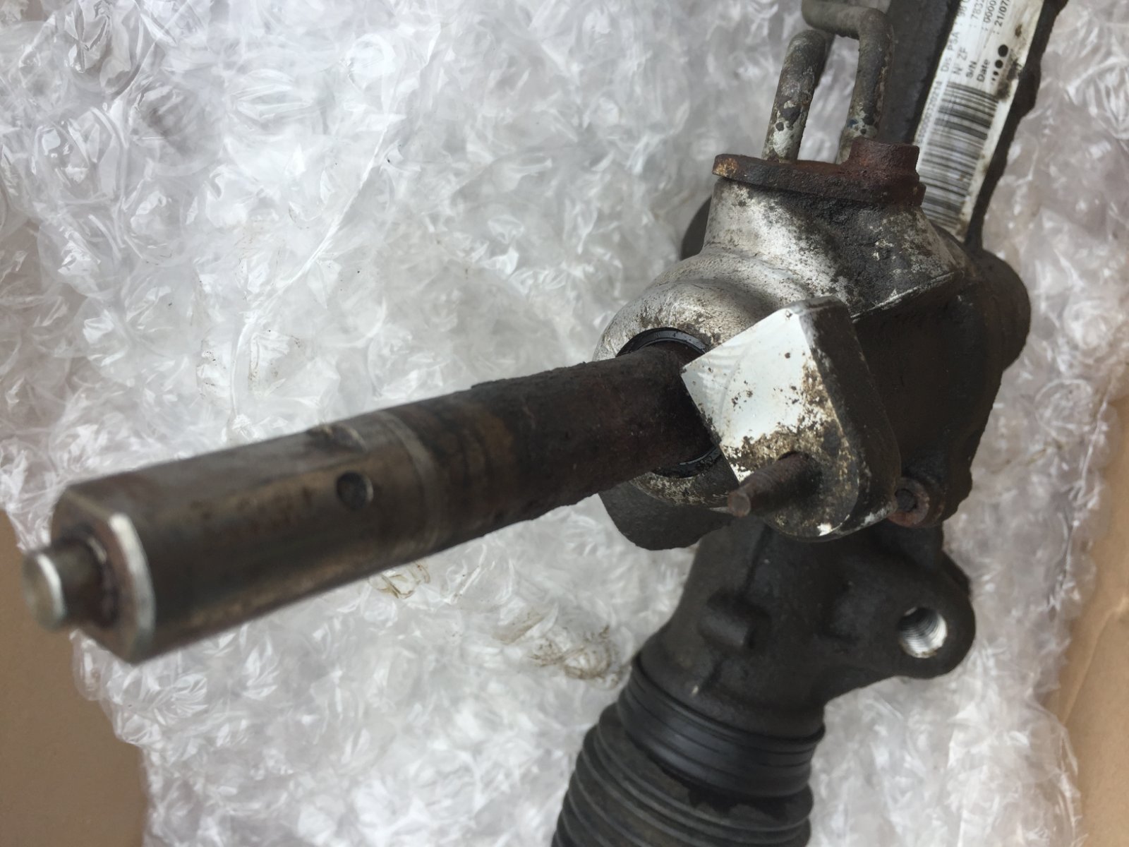

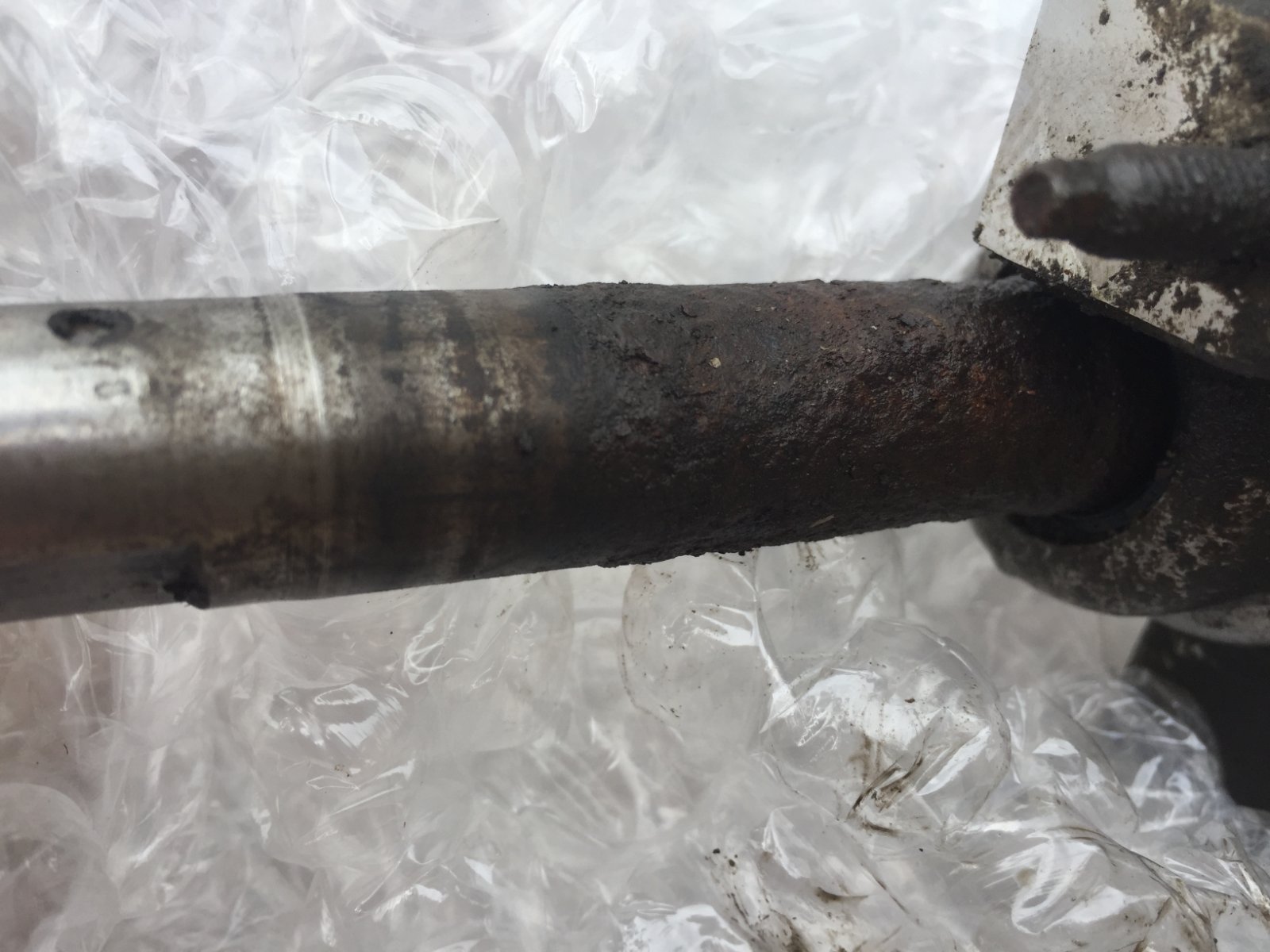

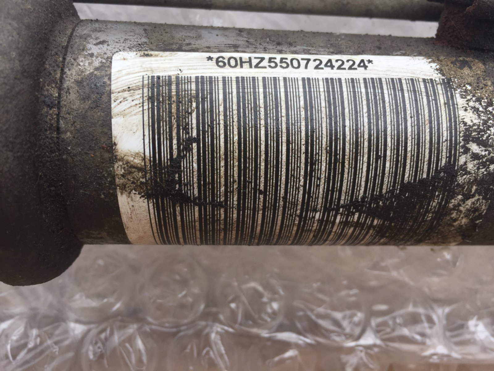

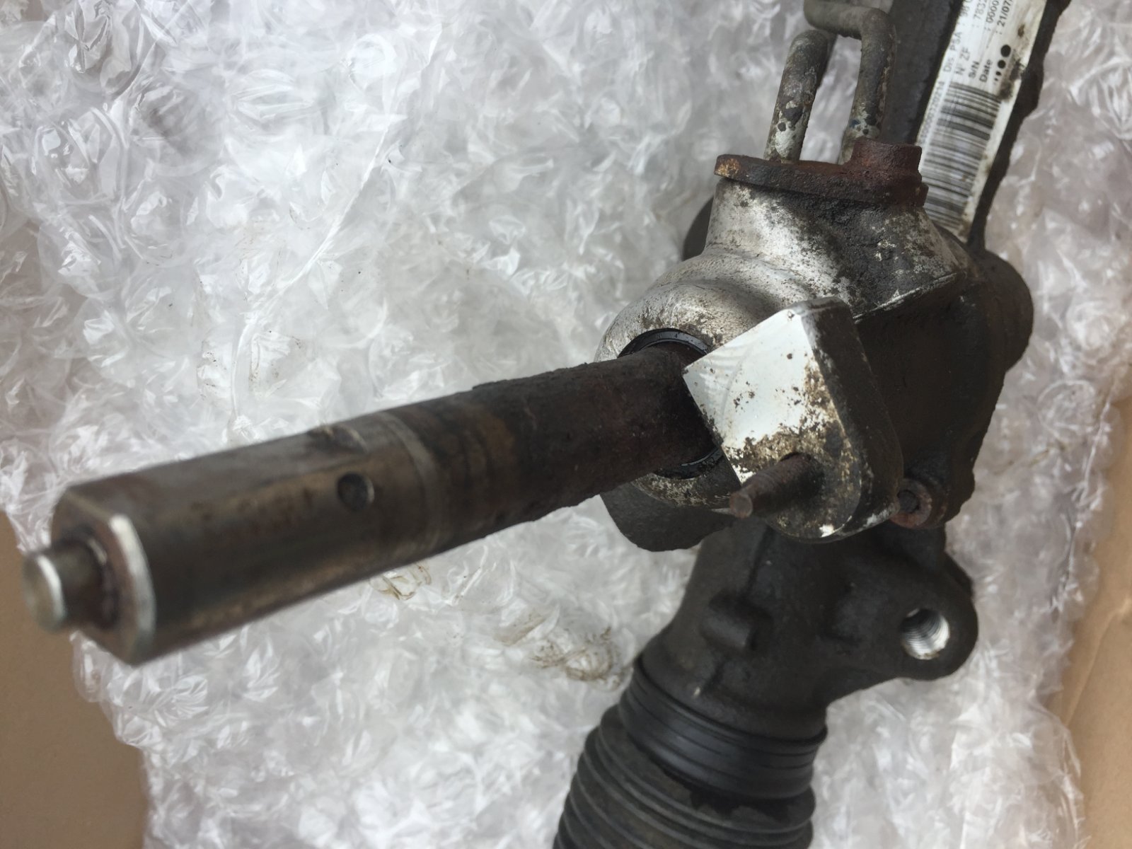

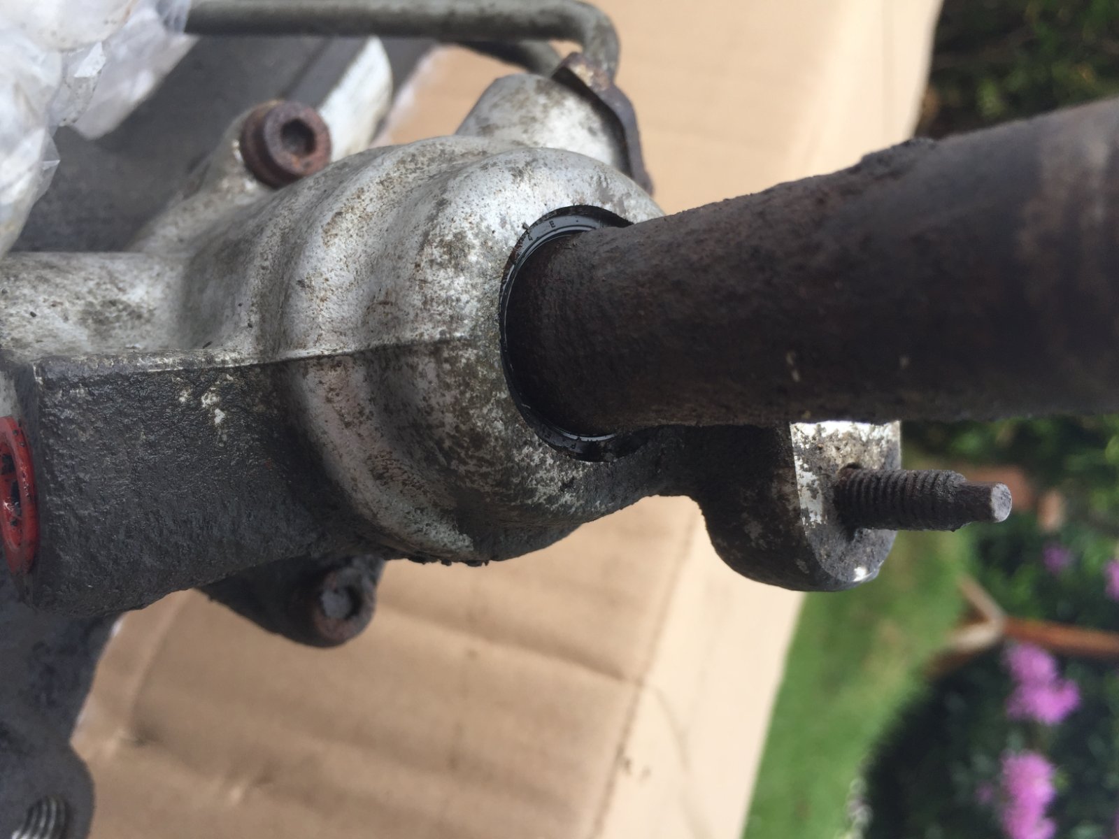

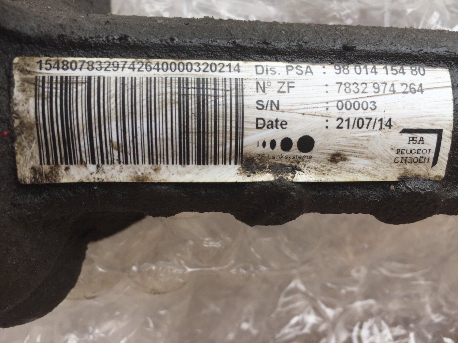

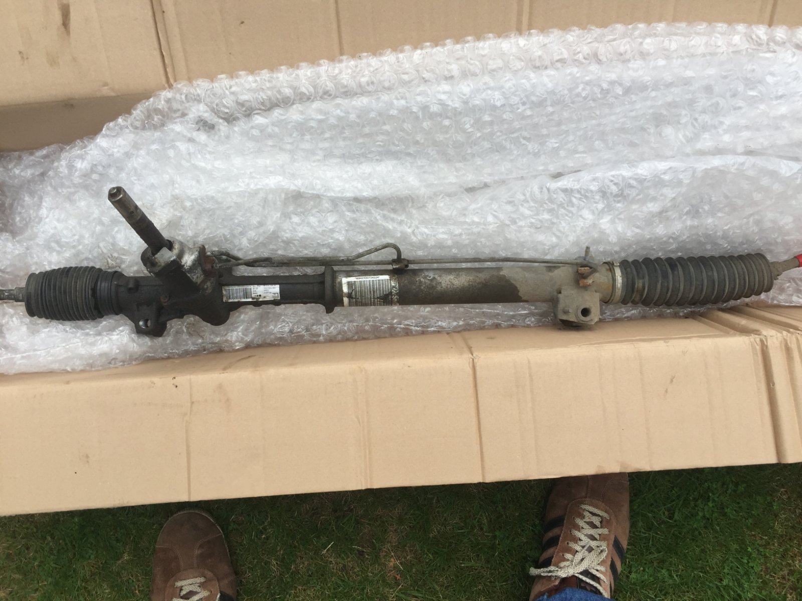

So as I promised, here are the pictures of the failed 'new' Citroen rack before I send it back to Autosteer.
These are high res photos, so you will need to click on each to zoom
(1) Here's the Full Rack(2) The Label for Reference (a ZF Rack)
(3) The Other Label(4) The Input Shaft

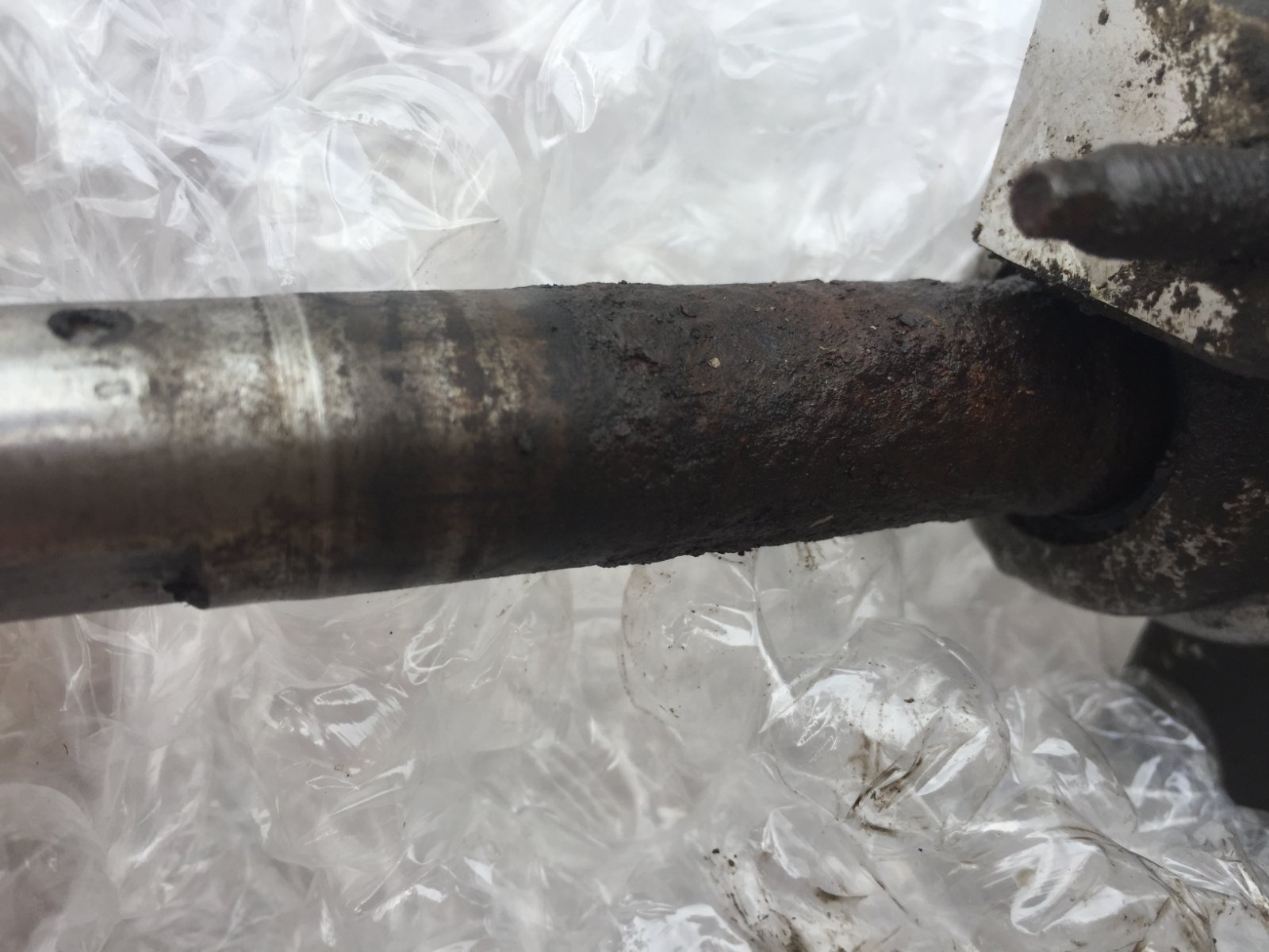

(5) Rusted to Hell(6) Another Close Up
So if you click on Picture (5), you can really see how much the rust has eaten into this in just over 3 years and 20k miles since replaced. We've had no harsh winters here in that time.
I would suggest that there is the possibility of water dropping down from the scuttle area onto the rack - or that pressure washing may be a possibility as I pressure wash it every month - but will be making a concious effort to avoid the scuttle more than I already do now.
I am very pleased with the work. The guys did a fantastic job and modification with the boot over the shaft - and they left the tie boot purposefully open at the bottom to allow egress. But they all agreed it was a poor design to allow water to just sit in the input shaft seal area and rot the shaft.
At this rate of reconditioning / machining- I suspect the shafts will soon be the size of matchsticks!
I'm now going to go and pack up the rack to go back to the sorting office, bleed the car myself (so I know it has been done as per recommendation) and be back in time for cornflakes :-D :-D

That really is a rusty shaft (oo-err missus) you have there Marc. This has all made me so concerned about my own steering rack but I will have to endure another week or worry until we get back to the UK.
x 1746
Re: C5 X7 Steering Rack - Again!
That exposed length of shaft looks well and deeply rusted along its complete length, and not just where water might be expected to sit in the annular recess just above the shaft seal. Can only guess how rusty it might be in the seal area itself...
Water will not be sitting on the shaft (well, it will be, when the rust really sets in!) - it will run downwards - so the conclusion has to be that the shaft material is just extrordinarily susceptible to rust. Wonderful.
See from pictures 5 and 6 that there looks to be just room enough to slide some snug-fitting protective plastic tubing over the exposed (and greased) shaft, and push it down into contact with the seal, and just into the annular recess in the casting. Some good grease at this bottom end might keep the water out.
Good to hear that fitting an over-boot was successful. Do you have any pictures of that, fitted, so we can see how it managed to deal with 'the lump'?

The rusty rack that you've just had removed was serial number 00003 - what you might describe as an early prototype !! I wonder if ZF are still churning out p/n 7832 974 264, or if they've modified the design again since then? :roll:
x 6945
Well no green Fairy liquid cap in there anywhere! Well let's just say that was a complete waste of a prototype 00003 indeed!

Wow, I don't think I've ever seen a serial number that low before. I always assumed manufacturers started at a random number as not to give away an details about production numbers!

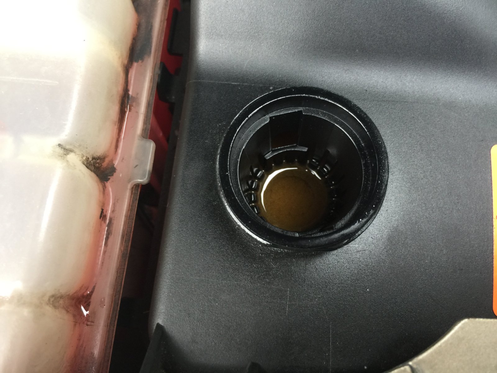

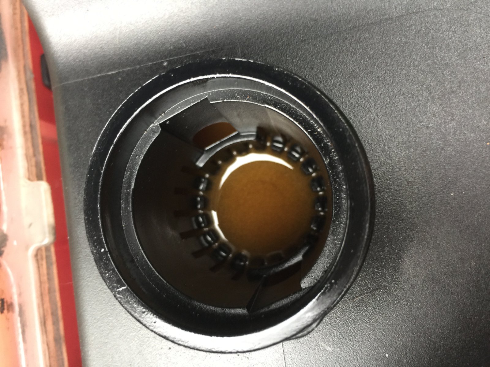

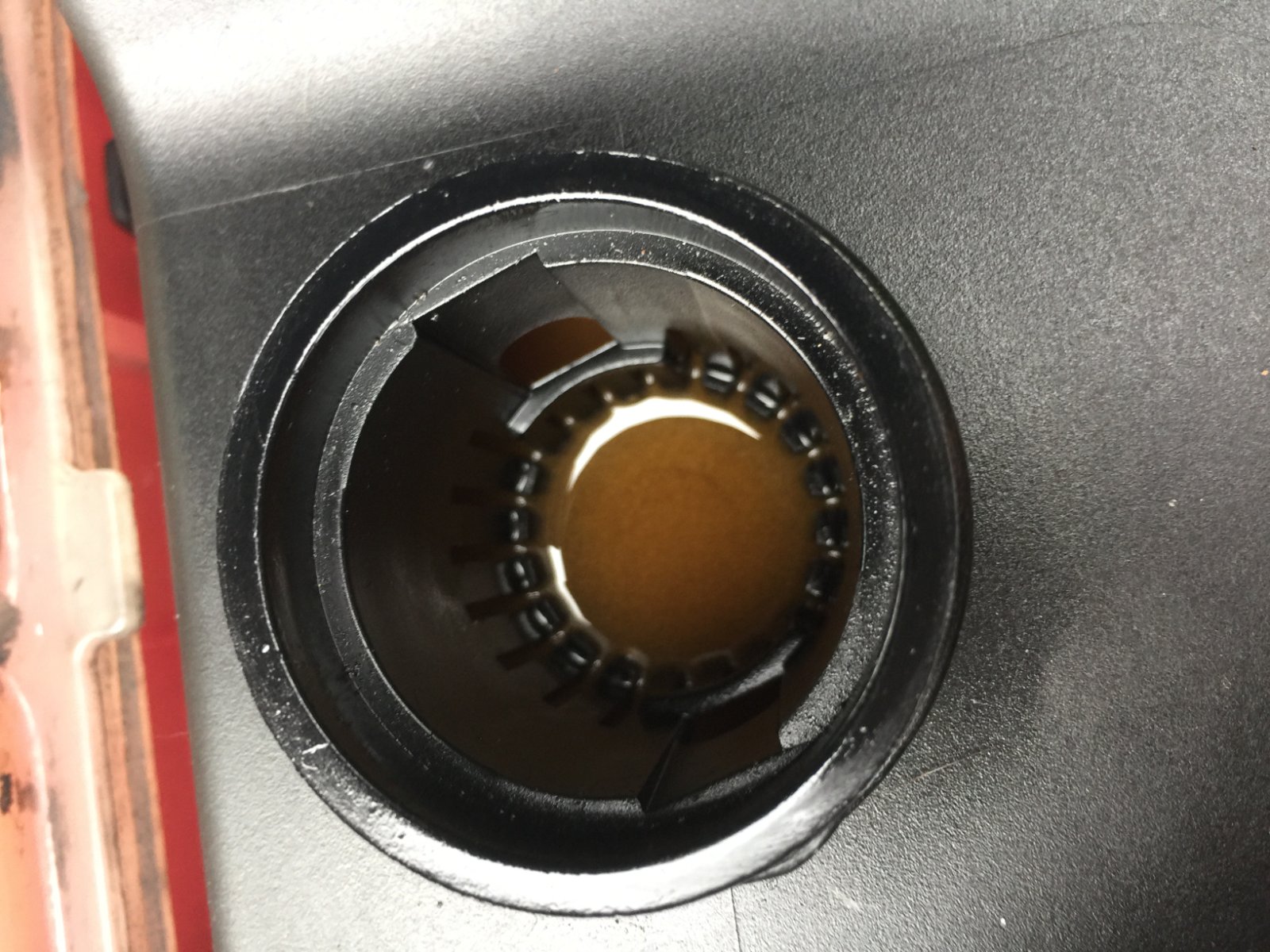

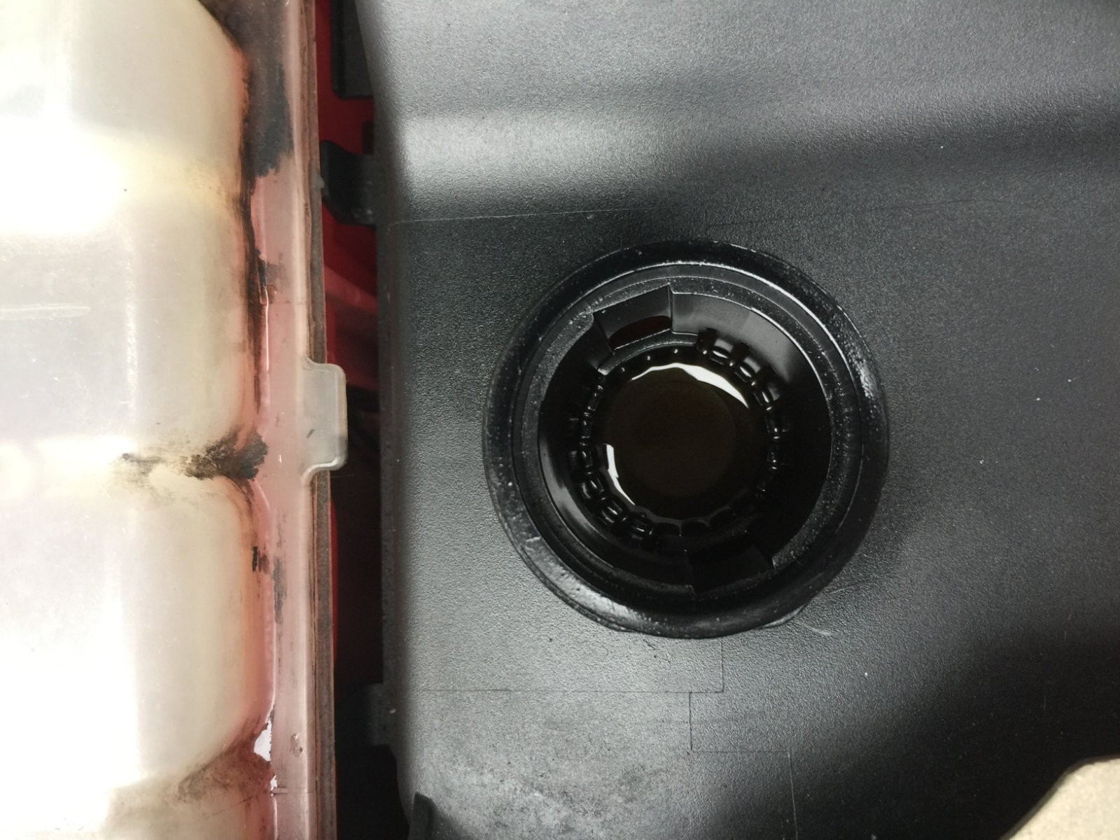

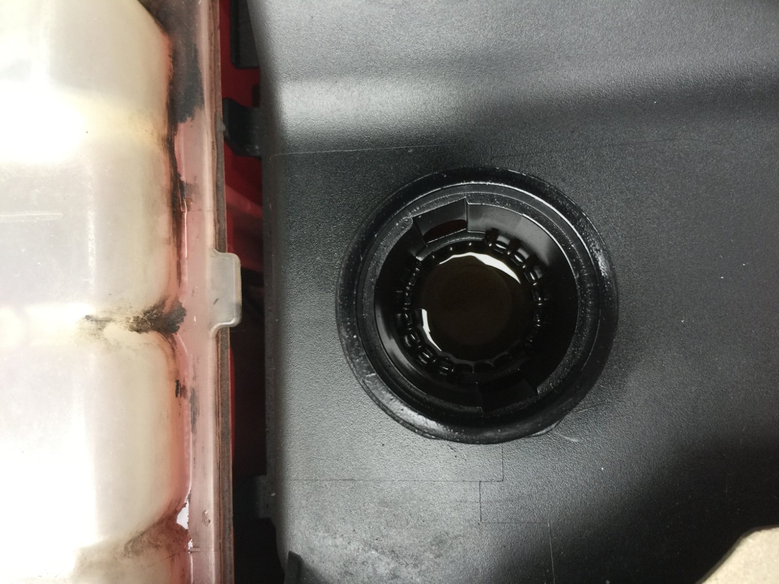

Decided to bleed the system to make sure it had been done as the steering felt a little 'lumpy' this evening on a spin to town and I thought I would put a few pics up here showing how the fluid was and how it is after bleeding:
Fizz ...
Full of microscopic bubbles
Going, going...
Slowly clearing
... Gone
Nice and clear
Usual procedure: Engine running, raise to high, lower fully, then 10 lock to lock SLOW turns, check level and then wait 2-5 minutes for tank to degas and any fizz to clear. I raised mine to high again and lowered it then performed another 5 or so SLOW lock to lock turns and let any remaining fizz disappear.
