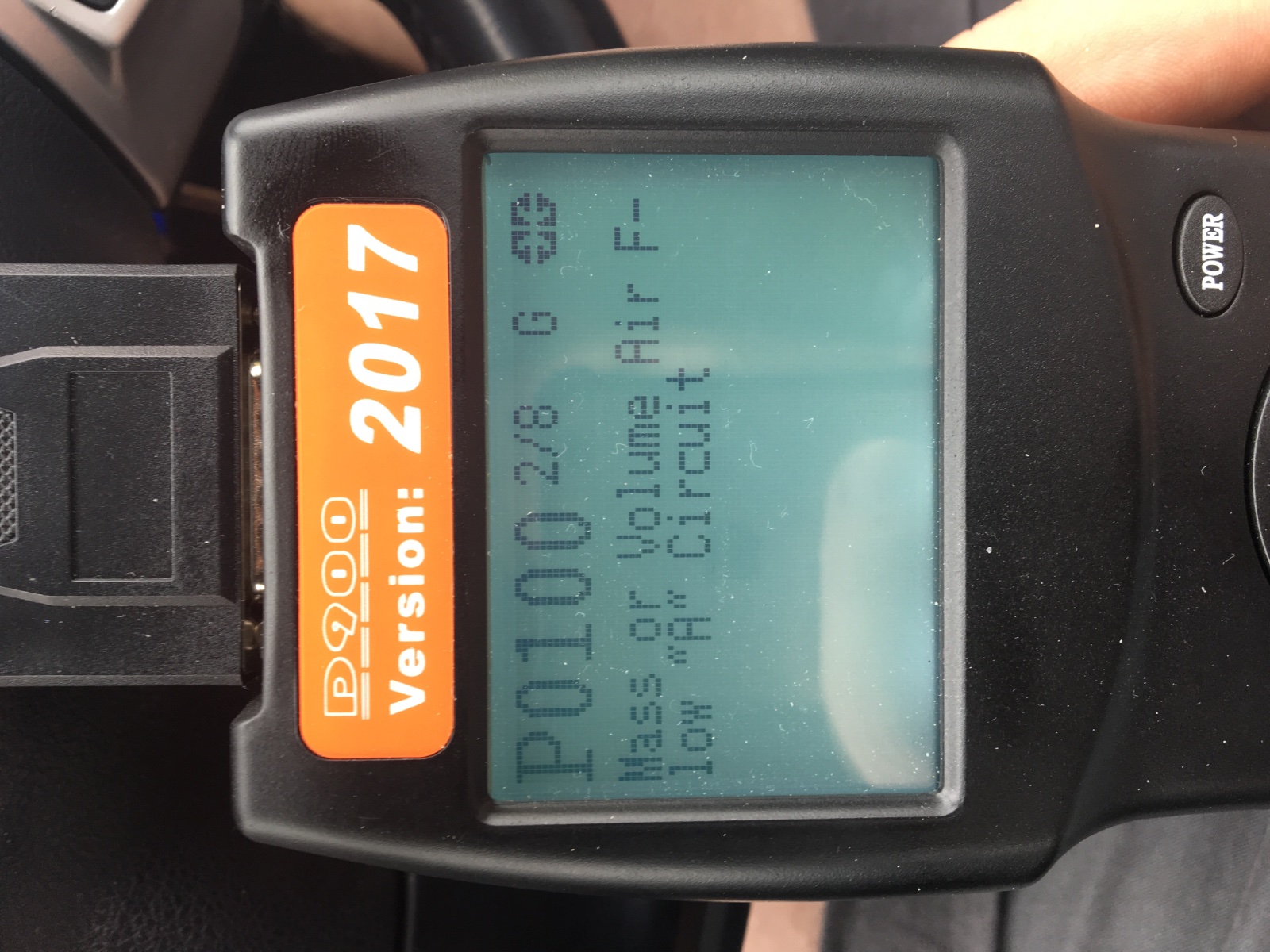

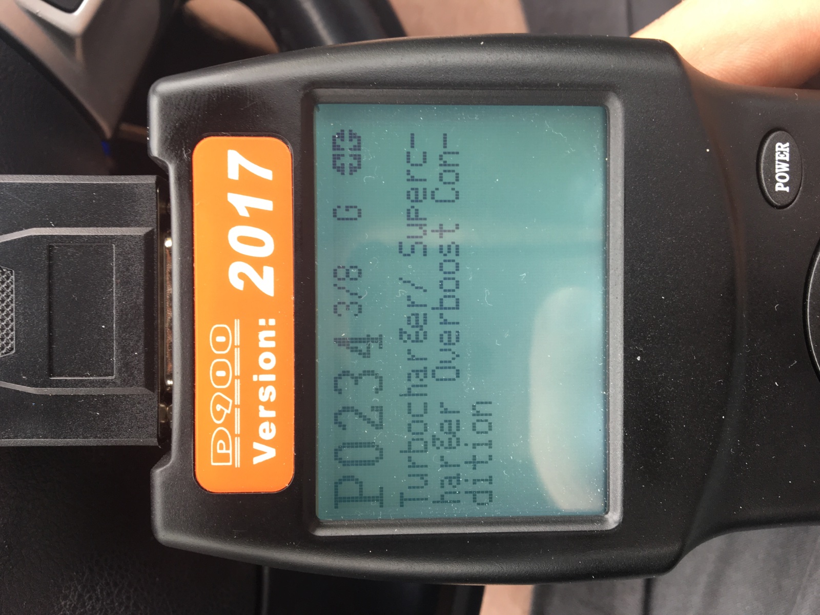

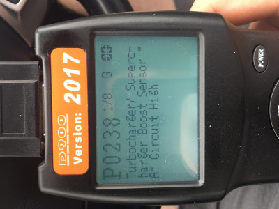

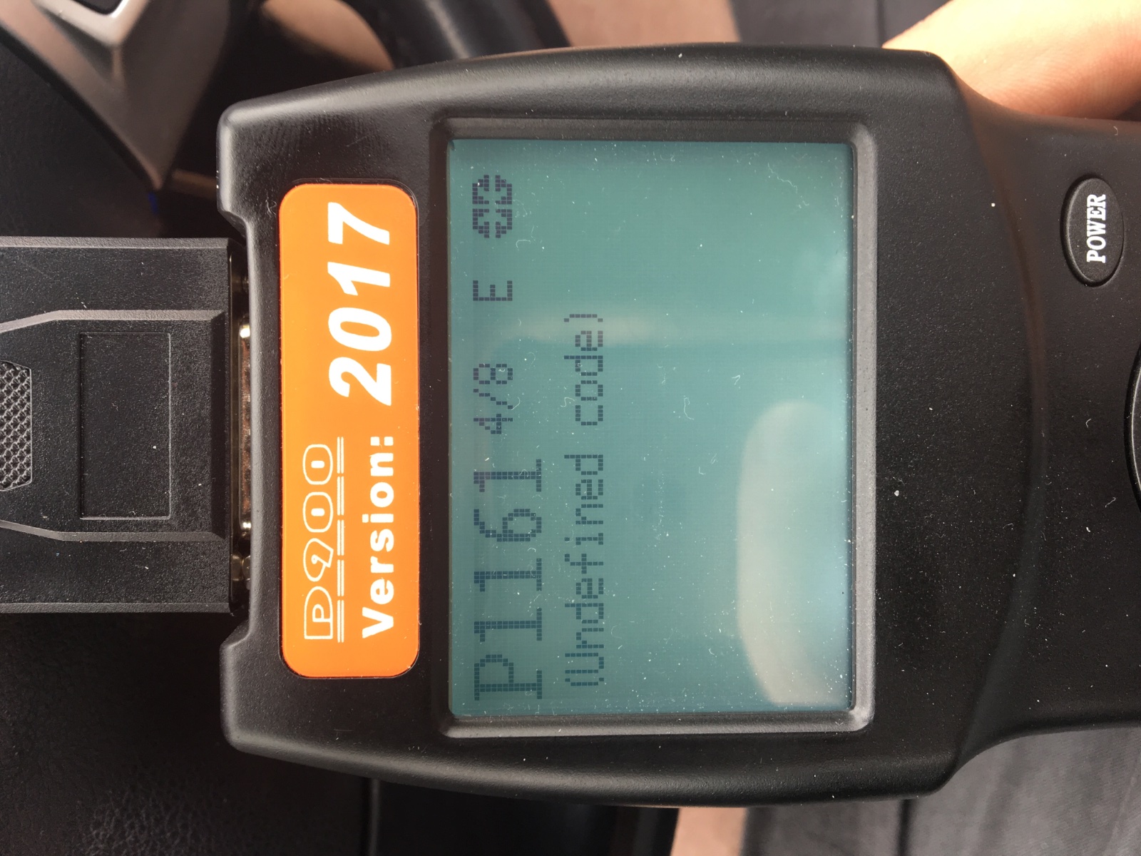

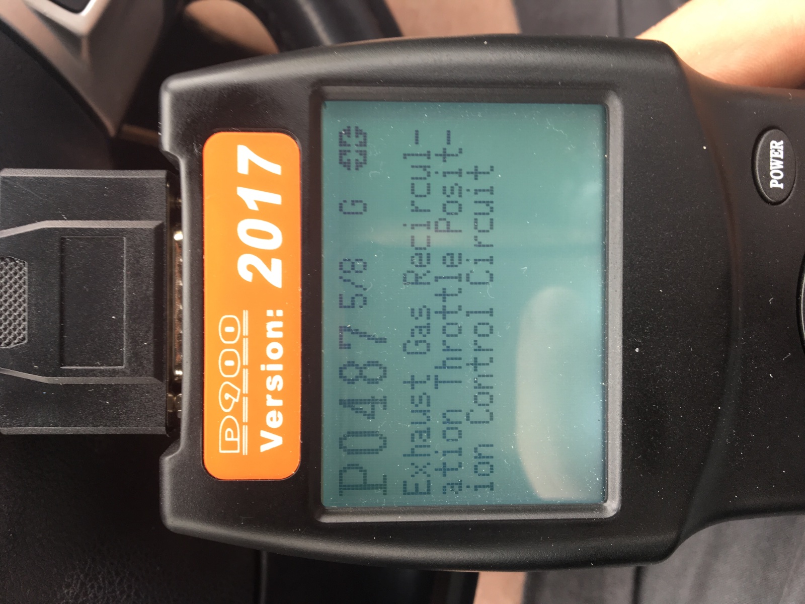

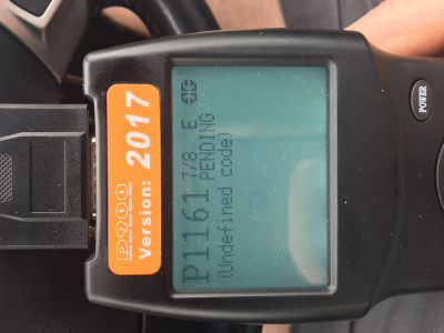

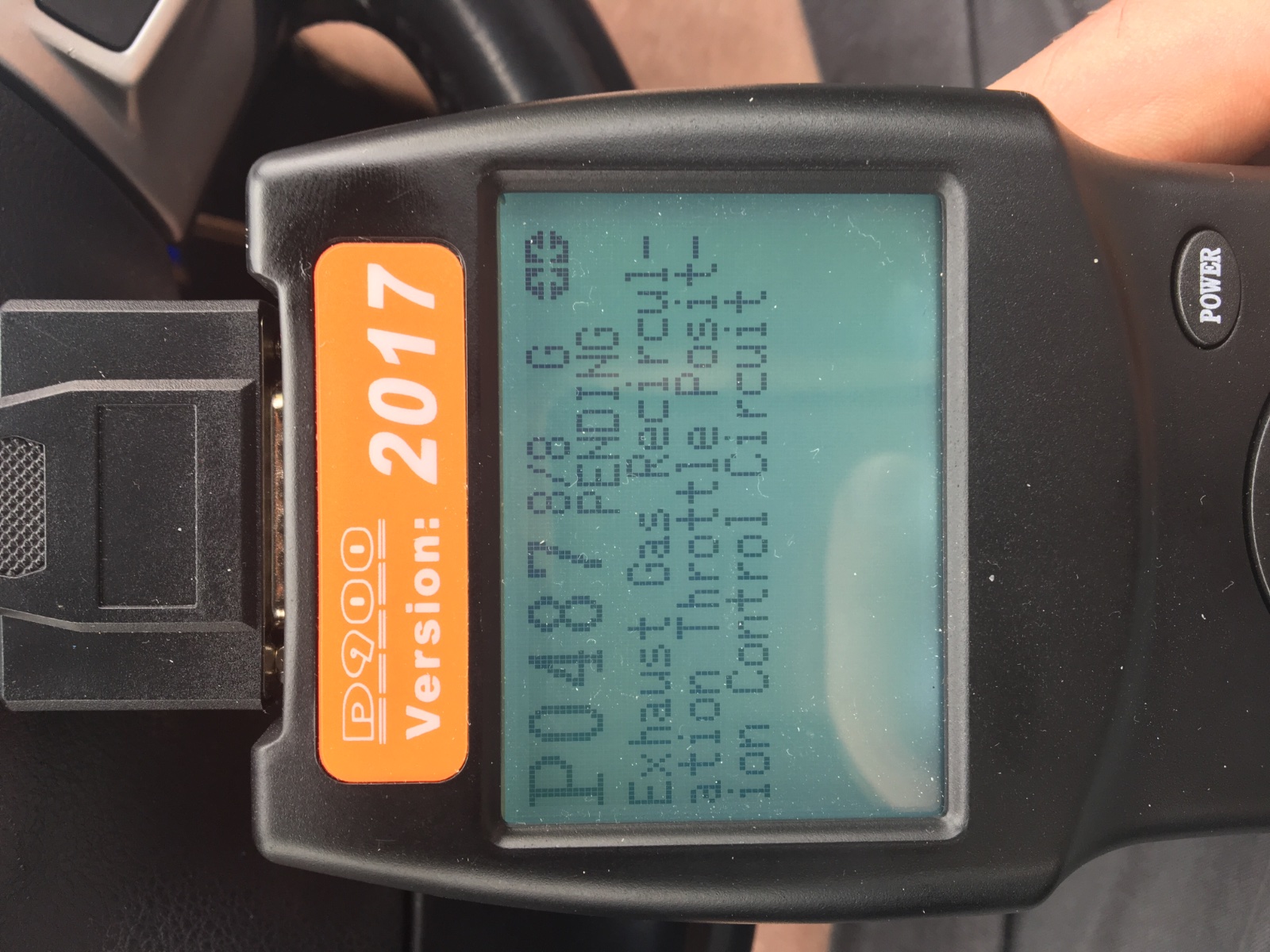

Have the engine management light on and poor fuel consumption.
Engine sounds fine and appears to run ok
Any suggestions on what could be coursing the issue
Thanks
Fault codes
- x 6955

Can we have a VIN code please? It would help identify engine type and options and with codes.

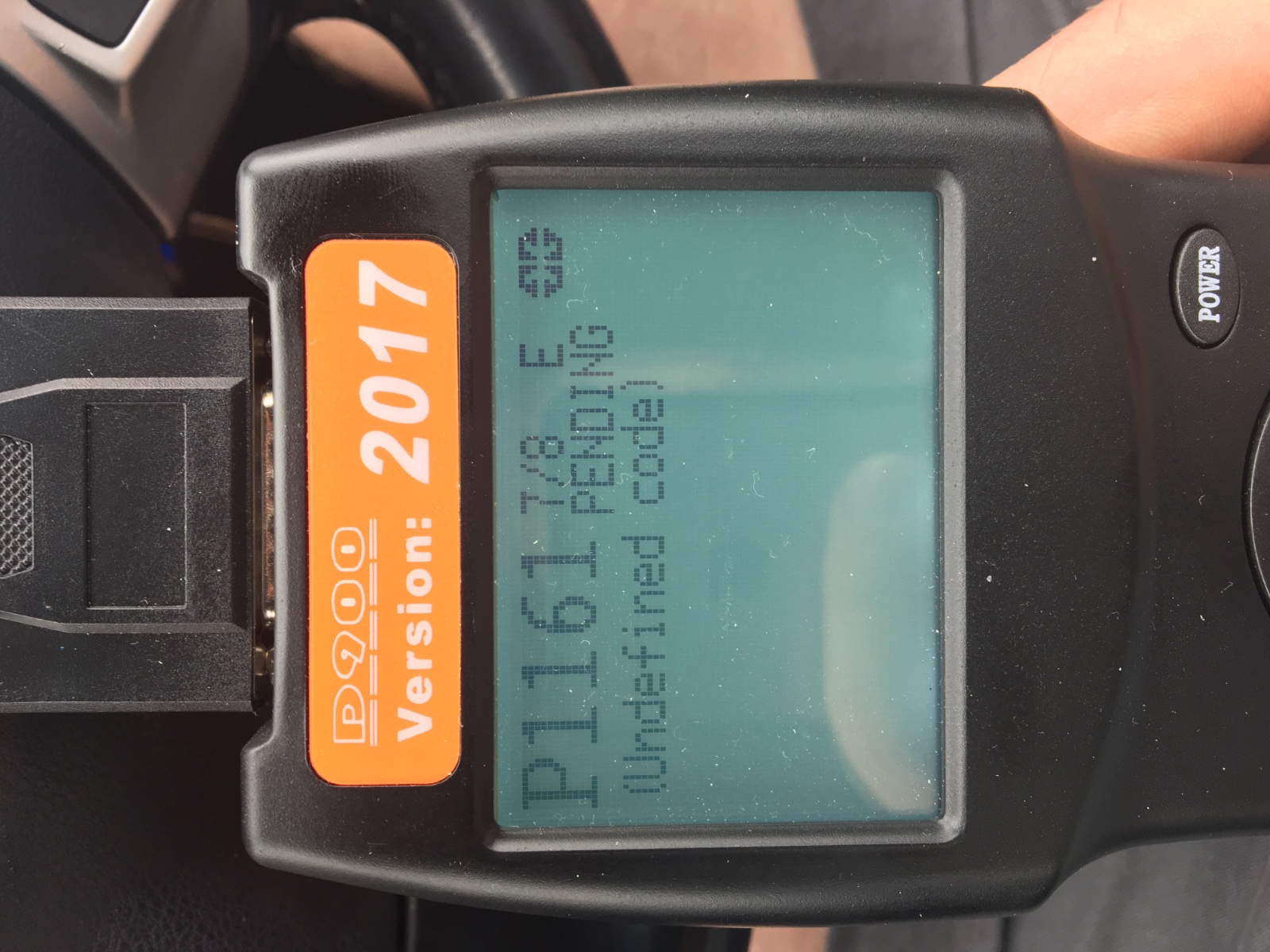

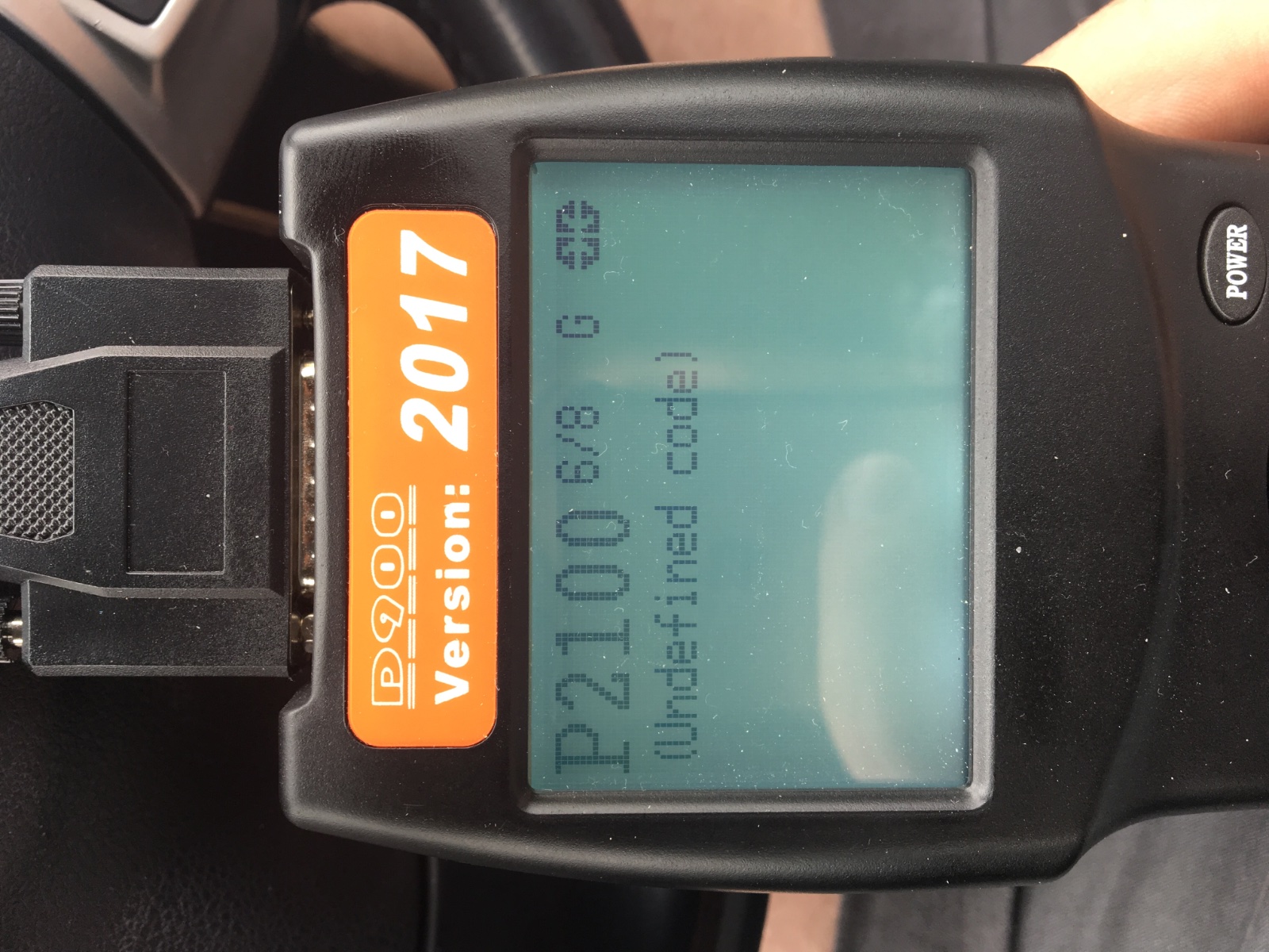

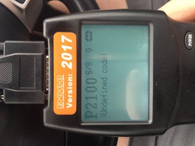

Initially and without a VIN to get the specific engine codes...
P0487 EGR electric butterfly position fault: Electrovalve jammed
Or: Mixer butterfly position copy signal : EGR throttle opening too low
P1161 - Mixer butterfly position copy signal : Butterfly jammed while driving
Or Fuel pressure regulation fault: Coherence of the pressure
P2100: Control of the mixer/butterfly : Open circuit
Or: Motorised throttle control: Short circuit between the wires
I'm wondering if the vacuum circuit is faulty, but would need your VIN to check specs.

Thank you for your reply it’s a 2.2 hdi
Will check vin and post
