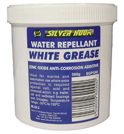

I've just ordered a couple of tins of that Silver Hook White Marine grease - just as well it's going on the car in various locations as it is lethal to aquatic life with long term effects! How they can call it marine grease is beyond me in that case

GiveMeABreak wrote: 28 May 2018, 19:21 I've just ordered a couple of tins of that Silver Hook White Marine grease - just as well it's going on the car in various locations as it is lethal to aquatic life with long term effects! How they can call it marine grease is beyond me in that case![]()
Let me know how you get on with it as I may invest in some myself.

This is the stuff - probably won't be in time for the rack - so I'll have to some other stuff on that for the time being. This stuff contains Zinc Oxide rust inhibitors too. Got 2 x 500g tins for £12.49 inc. delivery. I will be using this for the underside piping too now that they have cleaned those up for me and the height corrector fixings and anything else I can see that would benefit!

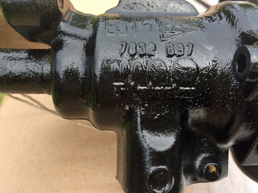

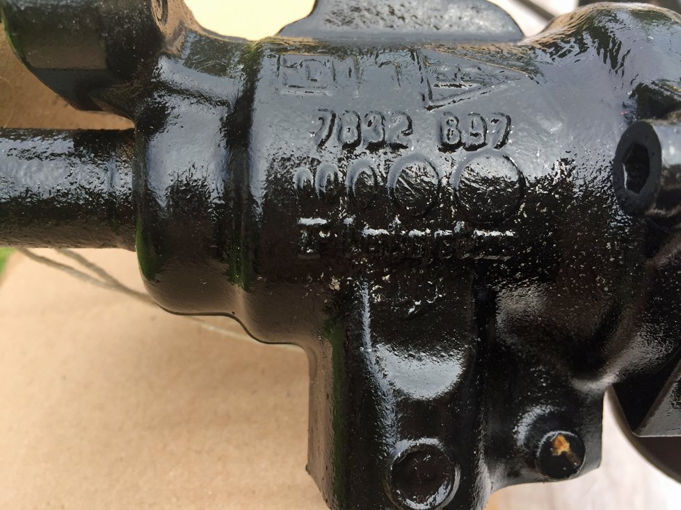

My new one is due today after lunch, so I will take a few shots of it and see if I can see any identifying marks on it for reference.

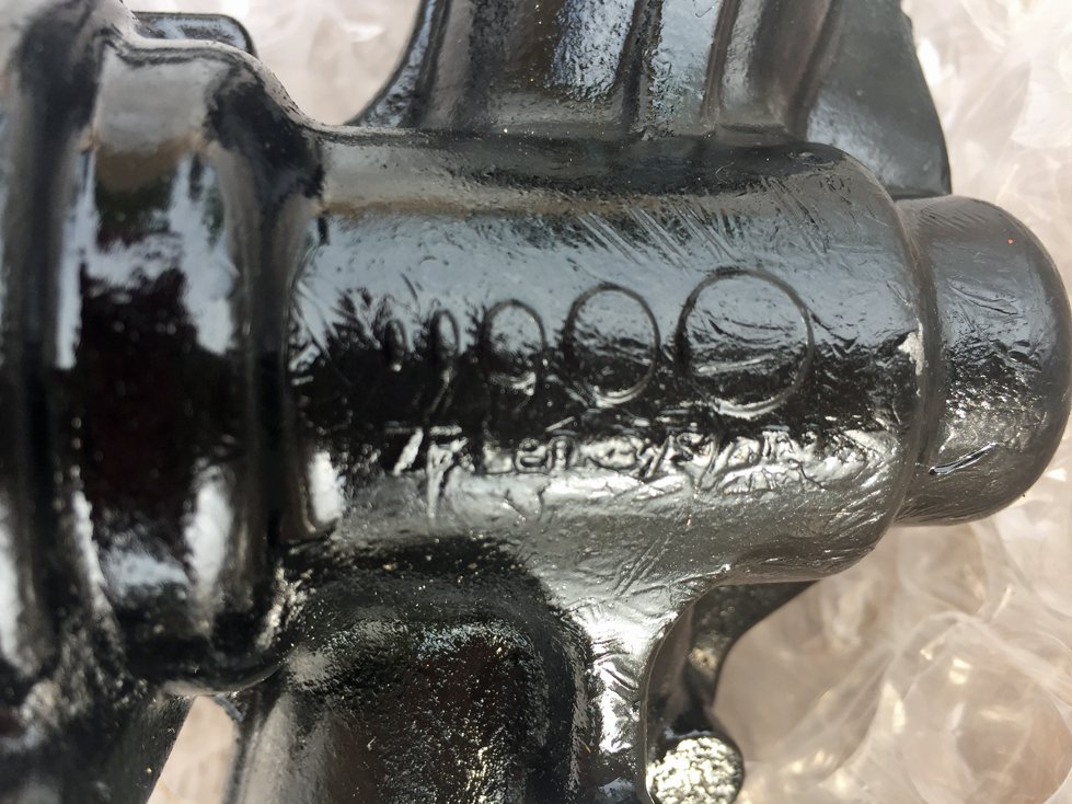

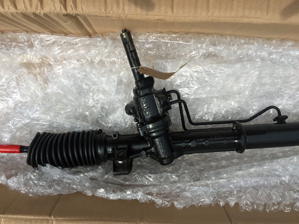

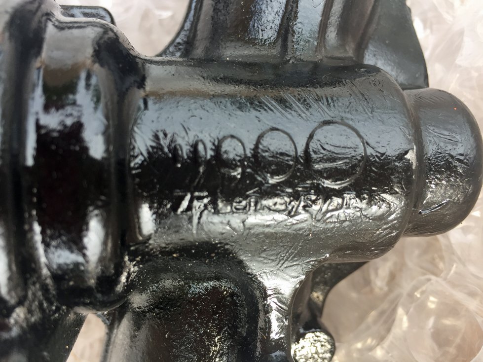

So the rack has arrived and I whizzed it off down the garage - but the chap doing it is off with chest pains (I hope not at the anticipation of this job), but seems to be ok.
It is a ZF one - has been coated as you can see, but I couldn't read the markings very well due to the coating and that it seems to have been through the wars!
No supplied green Fairy Liquid cap - so as it stands, any water will sit on top of the seal again ready to do its job of rusting the metal. Maybe the green plastic bung will be in my old rack somewhere once they take it out - not that it was effective at all! They are going to see what they can do to sort something to prevent the water from settling in the top, once the mech gets back from resting.

That shaft does not look like it has been machined to me, can I see some "brown" under the coating at the seal edge ?
- x 6956
Re: C5 X7 Steering Rack - Again!
Maybe the lighting Alasdair - I took it outside in bright sunlight - the shaft is rust free - but the coating seems to be quite rough generally - so whether it has something in it I'm not sure...

Looking at that third photo, Alasdair, I'd be tempted to
- clean up the shaft, polished would be good!
- clean up the cast area around the bearing and sensor lump
- cut a length of plastic/rubbery tube that will fit over the shaft, but will allow rotation of it inside, tube length as long as possible
- grease the shaft, and the top of the bearing (but keep the casting clean)
- place the tube over the shaft
- generously coat the bottom of the outside of the tube and casting with polyurethane adhesive*, to anchor the tube in place, waterproofly, and so it won't rotate; adhesive maybe up to a cm thick where it meets and surrounds the casting and its lump.
That will
- keep the weather out
- keep the shaft externally greased
- allow everything to be stripped off without damage if ever necssary
* I use PU298 polyurethane adhesive (a Henkel Pattex brand) for making suspension bushes/mounts, and also for windscreen rubber-glass surrounds. Comes in a standard cartridge, in various colours (including black). Squirts in place like smooth peanut butter, can be palette-knifed into shape, doesn't run or sag, and goes firm within a few hours. Cures by reacting with atmospheric moisture, and a thick mass of it goes fully rubber-like in several days, although quite touchable after 24hrs. Solvent for it is petrol, but clean surfaces to be adhered to with a thinner of some sort. Sticks superbly to plastic, fabric, rubber, metal, glass... Old/unwanted adhesive which has set can be cut away with a sharp blade.
Apologies for the sales pitch. Henkel, 3M etc have good few products like this. This one primarily sold here for constructional use.
