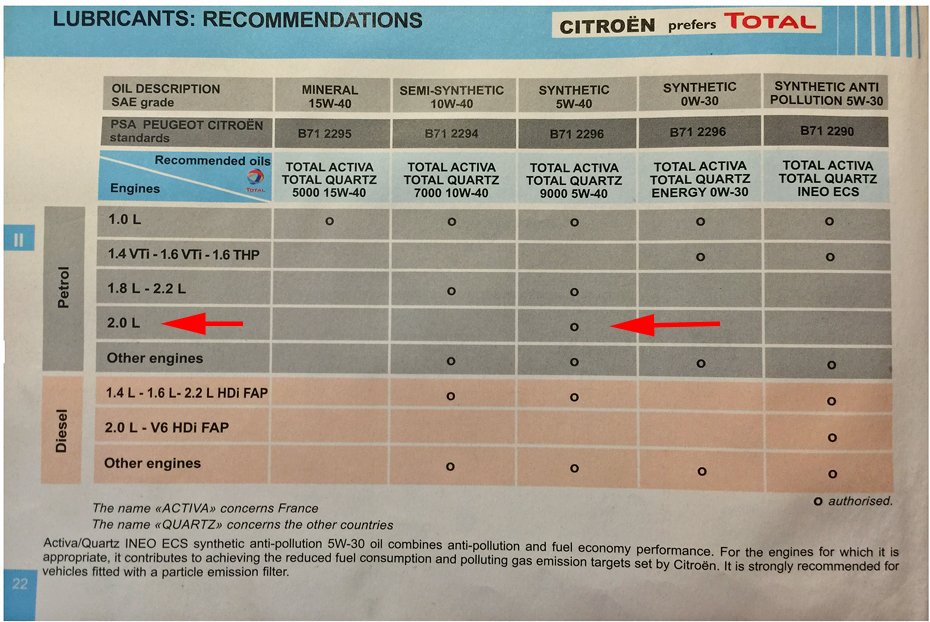

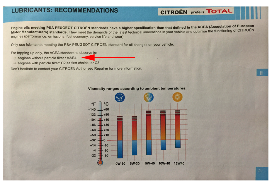

- x 6955
Re: C5 2.0i engine oil
Page 21 and 22 should have it - I've arrowed the relevant bits in Red:
Click to Zoom
So if you have a 2.0 Petrol:
Oil Grade: 5W-40
PSA Specs: B71 2296
