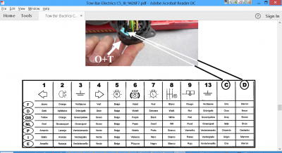

This is from the instructions that came with my Citroen electrics kit for the X7. Any help?

Re: Tow bar electrics advice please
Thanks Paul R the colour codes look very close I will go and check.
What are C and D used for?

From memory (the X7 is in the UK - I am not) C & D is/are the microswitch and wires that detect when a plug is inserted into the socket.
When the BSI is set up to recognise the wiring is present it will then alter (amongst other things) the braking characteristics for the ABS when towing. I doubt very much that the Mk1 would have the capability for this.
Hi Paul R.
Thanks for the reply. I have now worked out most of the wiring, your wiring diagram was very useful. Some of the wiring colours matched some didn't, but enough did to provide a good starting point. My mk1 has the fog light switch, wires C&D, the O + T threw me when I first read it. I am now working on the permanent live and the switched lives. Thanks for your input.
