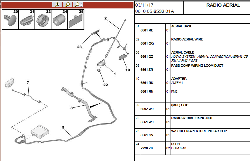

Ok so I have received your VIN now and you have the RNEG (MyWay) telematics system on your 2009 Tourer.
The aerial harness is number 5 in the diagram, which goes into the adapter (10)
Click to Zoom
So both the aerial base (1) and the aerial wire that screws in (2) are different - so if replacing, make sure you replace with the same part numbers in the diagram I listed, as others will not provide the functionality.

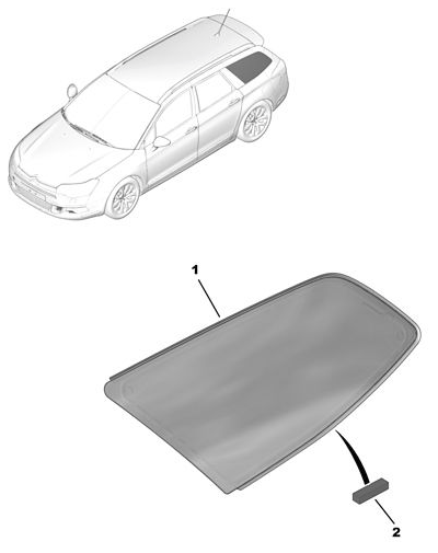

As for the rear quarterlights, they appear to be the same as Paul's -
Click to Zoom
| "- ACOUSTIC FR WINDOW+RR LAM+QUARTER LIGHT, TOUGHENED AND DUAL RADIO TUNER AND DEEP TINTED WINDOW" | Aerial Adapter Location |

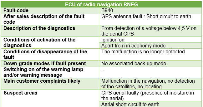

The GPS wiring goes direct to the aerial base I suspect - part 10 is only for the radio wiring - if you look below at one of the fault codes - you can see that one symptom of lack of satellites is a low voltage below:
So it is possible that there has been some water ingress / corrosion inside the aerial base. It is of course difficult to say for sure though as you can appreciate.
