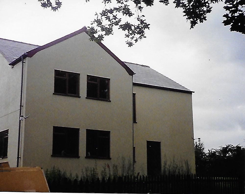

And the (almost) finished project. 1988-2002
