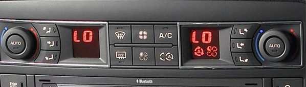

One of the climate control knobs in my X7 has started going intermittent - it's a common enough fault and will most likely affect all identical controls in the end. For the avoidance of doubt - it's this type of control :
Climate control
Climate control
It's the driver's side one that's playing up, so that would indicate it's a wear and tear related problem as the passenger's side still works fine and that gets a lot less use. I decided to take mine apart to see what's inside - hey presto....

Would it make sense that it is a Hall Effect sensor, or is it more likely to be a light sensor ? Is there any other type of sensor it could be ? Are Hall sensors known to go intermittent or are they either in a working state or fubar'd - same question for light sensors ? Could it be the ring that's at fault ? Is there anything that can be done to make them good again ? Re-magnetise the ring ? - or is that barking up the wrong tree ?
Any ideas ??????
