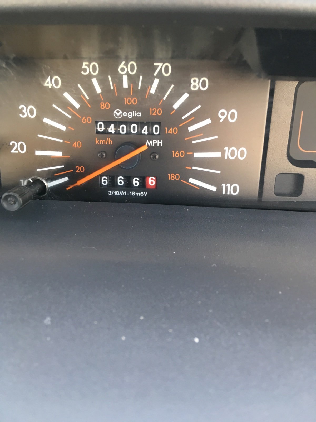

A nice mileage pic on lil pug last night

daviemck2006 wrote: 18 May 2018, 20:01 638C58D7-013B-46D9-8F66-13B660EF1F92.jpeg
didn't spot that one Davie to get that precision, credit has to be given. Is there a bit of a tale of the when and where of it
Excellent! There is a thread on significant milage photos on the OTCL

It was total chance Neil. The trip has never been reset since Ive owned the car over 6000 miles ago, as the reset doesnt work. And its total chance it happened at a wide open farmyard where I could get off the road to photograph it

Still reckon the 205's instrument panel is right up there in my top 10 for most pleasing overall design.
