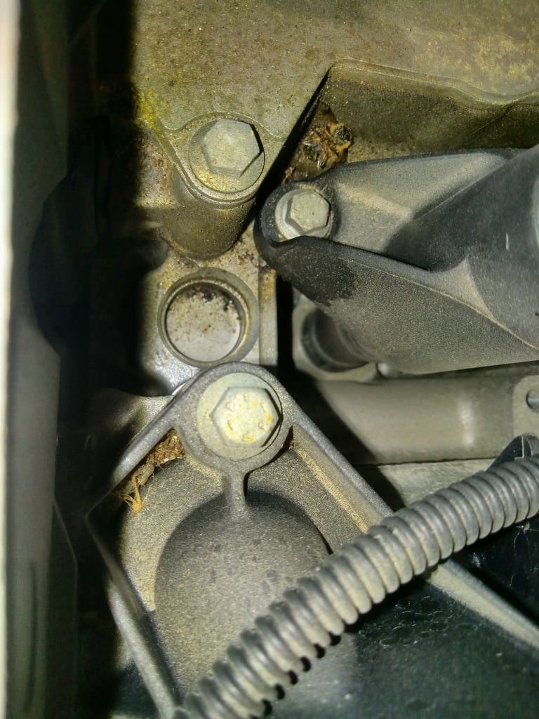

Was going through nice and slowly, got the airbox out, the piping off (carefully - as they seem like they could be rather brittle from what I've seen - a job for another time I guess).
Got the MAF sensor off. And started on the inlet manifold bolts, all but one would budge. I'm pretty sure they were overtightened by the indy that did the major service a few years back (cambelt change etc).
The bolt felt tighter than the others, and was about as rusty as the others. I tried loads of things and I think I started to make it worse, I practically gave up, thinking I might need to get the local mechanic to get it out.
I did also look online at what sockets could be used for that kind of thing - grip-tite, irwin etc, but couldn't really find anything in my usual array of stored around here that might have that kind of thing.
However, I did notice that most of these had more of an odd flower type shape to them, and I was thinking that I saw something similar in my box of tools, in the form of an E12 socket. Not exactly the same, but it didn't stop me trying. Poped it over one of the loose bolts to ensure I could tighten and untighten the bolt - and it was working.
So thought I'd try it on the nut, only problem was I couldn't find my 3/8ths ratchet (later to be found in the box with the spark plugs and coils ordered - great memory I have there for where I put things #-o ). But I was determined to get it loose (it was getting dark too so I was running out of light), using some probably rather ill advised bits - a wrench and one of the angle extenders.
I knew I was onto something when the E12 socket was stuck tightly on the bolt head, so pressed on, and sure enough it came loose, a huge sigh of relief.

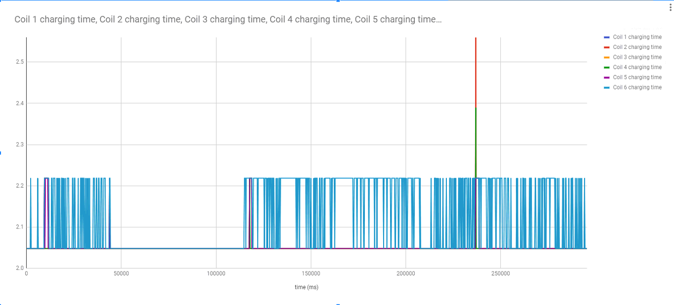

One thing I did notice as I was monitoring the coil charge times again.
#6 was fluctuating a fair bit, as per this chart - though the rest were consistent.
Not sure if this is something that would have killed the previous coil? and whether it needs looking at, it sounds like this is probably well within margin of error, but I am one for trying to make sure everything is in order
