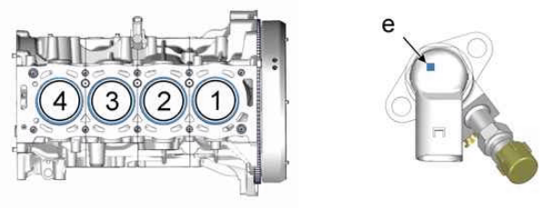

Re: Injector class mixed up, hot starting issue
I'll need your VIN to confirm, post or PM it, but I suspect you you have the DW10BTED4 138 for the MK II with Siemens Injection variant:
| Marking of the class ( as "e") | Correspondance |
| 4 | Minimum |
| 5 | Nominal |
| 6 | Maximum |

GiveMeABreak wrote: 09 May 2018, 07:58 I'll need your VIN to confirm, post or PM it, but I suspect you you have the DW10BTED4 138 for the MK II with Siemens Injection variant:
Marking of the class ( as "e") Correspondance 4 Minimum 5 Nominal 6 Maximum
Thats right. I now have class 4 in in cylinder 1 and class 5 in the remaining. I checked these dont seem to have individual injector codes.
Probably a previous owner just got a class 4 injector in place of 5.
