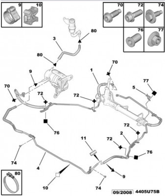

It seems like at the moment that there is a new post every day about another X7 steering rack failure. Did you keep the pinion shaft coated in grease after it was replaced ?
I've not done anything with mines yet, i'm waiting on a LP pipe which is back order at the moment. Spoke to a guy at Glasgow power steering services who seemed very knowledgeable about this exact problem (pinion valves & pipes), apparently its the LP pipe that also corrodes & there's no point in doing the rack without also replacing the LP pipe, he has lost count of the amount he has done & never had to replace an HP pipe yet. He has 2 stuck in his workshop right now also waiting on back orderd LP pipes.
x 6957
Re: C5 X7 Steering Rack - Again!
Yes I told them to grease it specifically. So you are referring to the low pressure pipe as in part (2) of the diagram that needs replacing?
x 3566
There is a slight chance it could be a misdiagnosis and the leak is coming from the pipe seals where they enter the rack. The distance between the pinion seal and pipe connections is only a few inches.
x 6957
Thanks for that info Robin, I was under the impression that the seals weren’t available separately though?....
x 3566
Officially they're not available separately - they normally come packaged with the power steering pipes handily attached, but HNBR seals can be bought to fit at the cost of a few pence or the seals for earlier C5 apparently fit - as per this eBay advert:
https://www.ebay.co.uk/itm/PEUGEOT-CITR ... 3193195357
For info - the ones in the advert are silicon, whereas HNBR are usually green.
