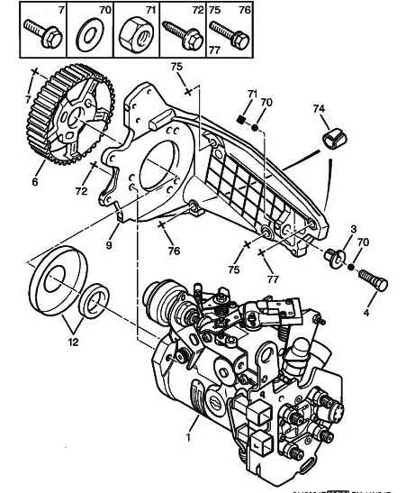

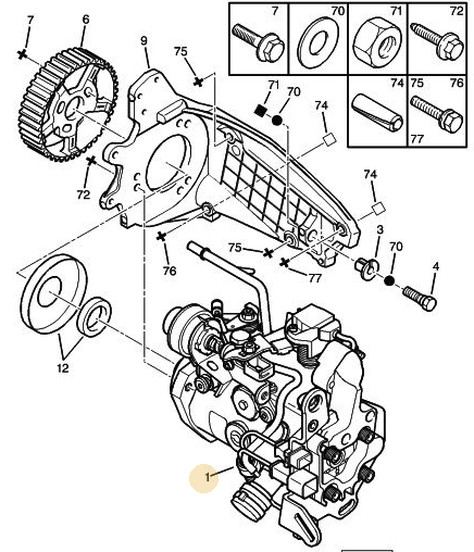

I thought I'd put the diagrams of the 2 pumps up for comparison - and you can see that from the pictures they do look very different in places.
| Pump Part: 1920 6K DW8 | Pump Part: 1920 AP DW8B |

Re: Can I transfer an injection pump from a non-ECU DW8 to a DW8B?
Hmm, so they do. I wonder how much that matters though. I can see the timing belt sprocket is the same, depends what that pipe coming out the top is for - fuel return maybe?
I guess the question comes down to whether the injectors are any different, and the pipes will fit in place. I have a Citroen Service account myself so I'll take a look around there.
I guess the question is whether these differences will mean they can't be interchanged, or if it should be OK
