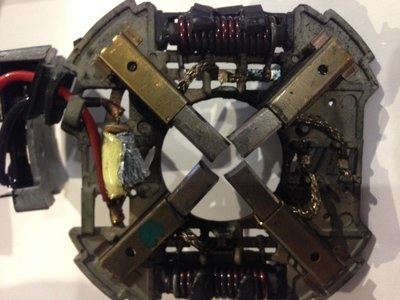

Thank you Lexi for your comment it gave me the momentum to remove the pump to see what was going on even though I did not know what I was going to do or expect once pump removed, however I put a multimeter across the two main terminals on resistance at 200k and got a reading of (I think) 9.98k.
While removing I did short the body of the motor from the body once but not a great spark, pump removed and I attached two wires from an old battery across to the two terminals on the motor small sparks but did get some movement, decided to open the motor to see the situation, found the capacitor opened up like a book and when removing the cover from the terminals I saw what I first thought was two ball bearings, on close inspection of the terminal block that is all covered in shiny black paint I noticed under a wing of a clamp a shiny surface which I think might be the sight of where the solder has come from.
Realisation I have now put the multimeter across the two terminals and it is just open circuit, now wondering if I have caused this burnout and not found the cause. In my rush to check if the motor would turn.

I would put the feelers out for another s/h motor unit. I don't know if that capacitor acts as a starter to get the motor going or what. The motors with ecu go for around £70 at scrappys. Hope your availability is better than up here, as it is easier to buy a full car than find one in a yard. I think someone on here replaced bits inside the motor. Whether it was brush wires or the capacitor, I can't remember.
Good pic of the motor. Is the armature and commutator good? The forum is a bit quiet at weekends but there are a few leccy whizzes that might come on to your thread in time.

I would replace the blown capacitor rebuild the pump and bench test it before going to any more expense.
To test it secure it in a vice, connect the main heavy pos & neg cables to a battery then run a pos wire to the thin exciter wire terminal on the pump, the pump should run.
Looking at the brushes I think you might be on a winner, they look very little worn, clean and unburned.

Thank you Lexi & Gibbo2286 for your comments, I have looked on the selling sites and there are some units all requiring postage and very varying prices, also trying various yards that I could get to.
But I have also been looking at some other posts on FCF and there is one that discusses the capacitor (a 0.22 micro farad and 22 electrolytic size) identifying that it would not do anything for the power but probably more to stop interference on radio etc, however if that's the case then how would you get enough power through it for it to explode?
I do agree with you Gibbo2286 regarding the minimal wear on the brushes, the armature seems as good on inspection of the end, I have not removed it all from the body but by hand it does turn and requires a bit of force which you would expect from a high pressure pump.
I am keeping my options open, on a cost basis worth trying a new capacitor!
