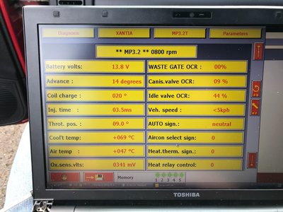

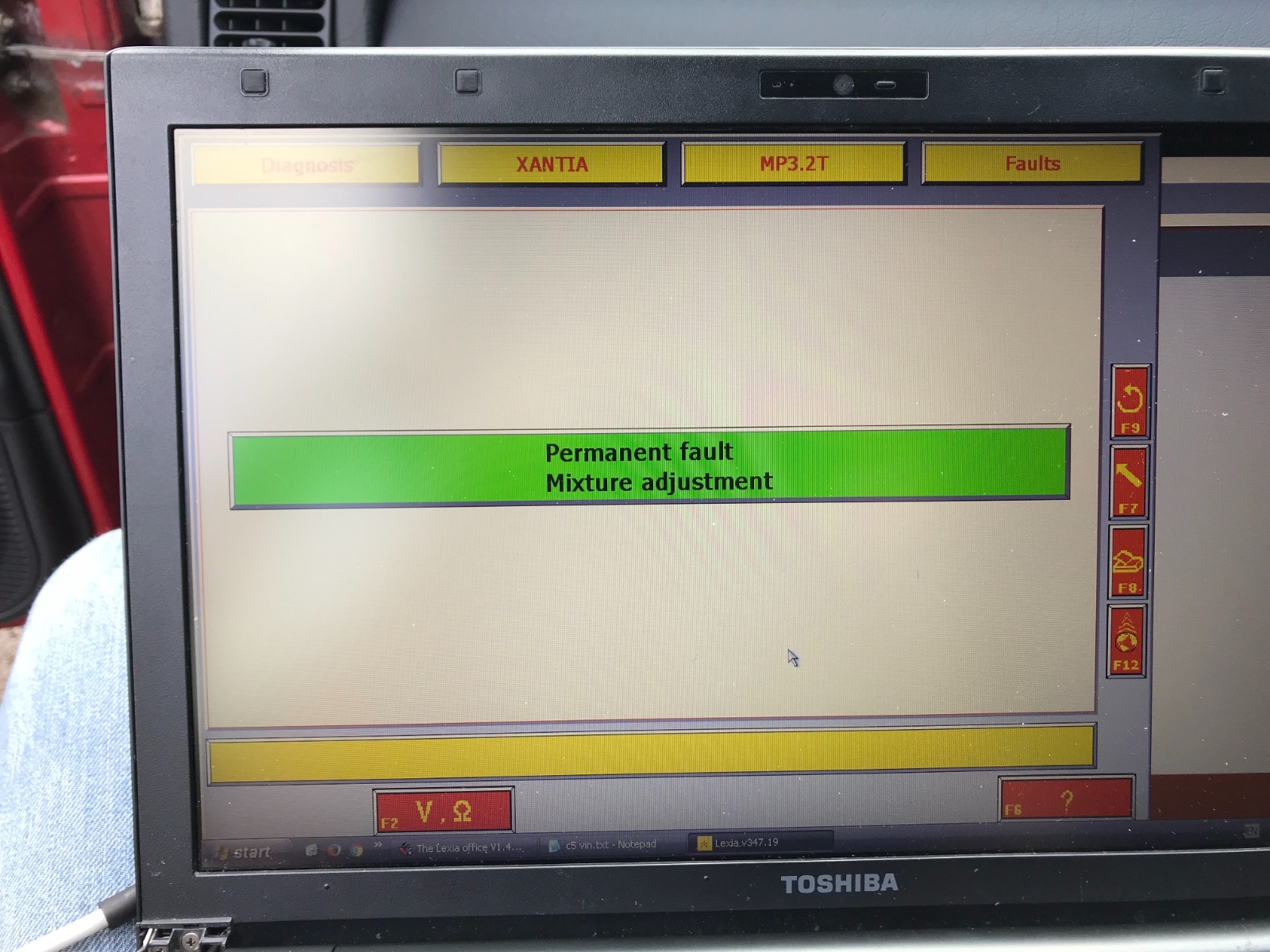

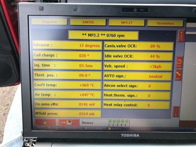

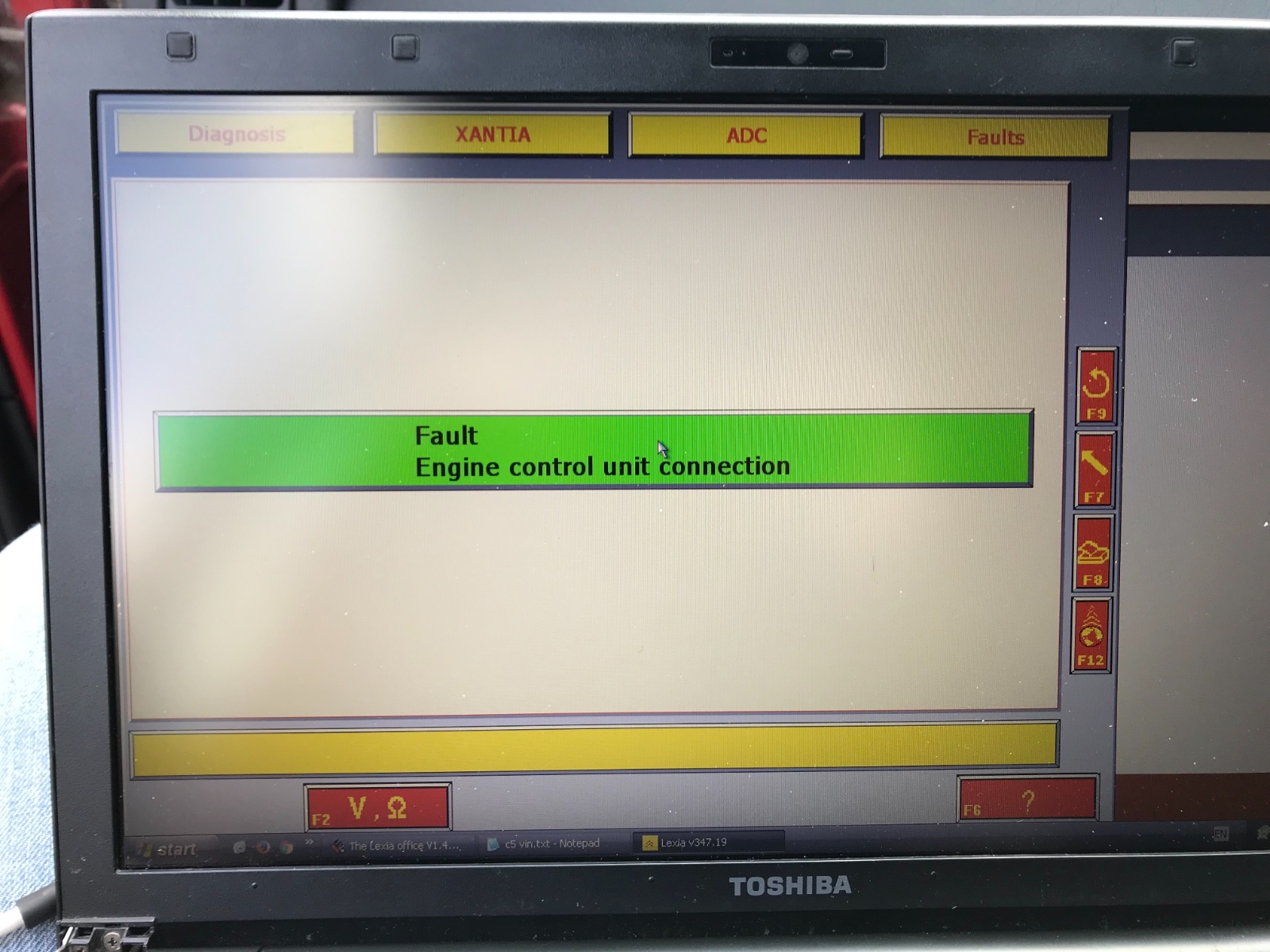

I tried Lexia on it today and it came up with the fault code:
"Permanent fault - Mixture adjustment"
Now what I can't decipher is.. Is this fault the cause of the problem, or is this fault an effect of it running on 3 cylinders so the o2 sensor detects a lot of fuel in the exhaust?

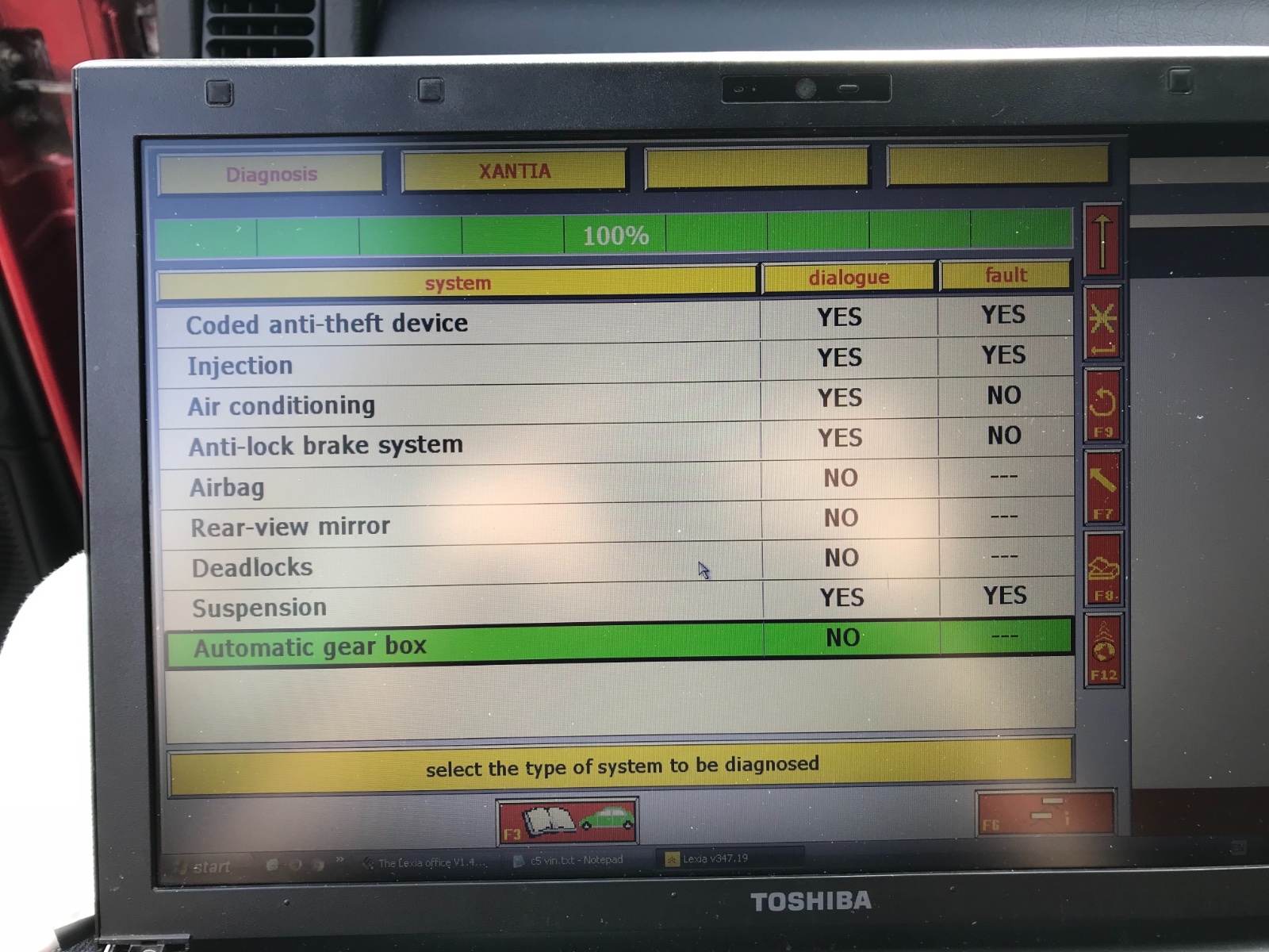

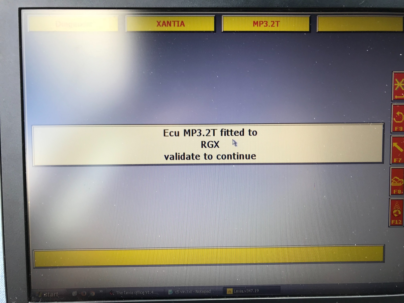

I did also have a fault in the Coded anti-theft device, showing as "Fault - Engine control unit connection". Is this fault related? Could it be the keypad has previously been disconnected and a start attempted? I've never cleared fault codes on this car before.

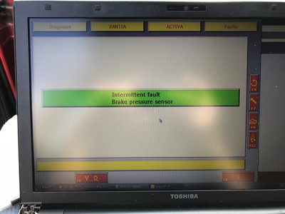

And for completeness, there was another fault in Suspension, showing "Intermittent Fault - Brake pressure sensor". This was cleared. Does anyone know what this means? As it is linked to the suspension ECU I presume it is related to switching to hard mode when braking?

Oh and also - can anyone shed any light on why Lexia doesn't communicate with the Airbag ECU? Or the alarm ECU - that doesn't even show up!
I've got random alarm issues which I presume is down to faulty ultrasonics but without lexia I can't confirm which is the problem.

On the airbag and alarm communication issues, I think you're doing well if they're the only ones you struggle with! If the alarm randomly spontaneously triggers unless you disable the volumetric protection then it's likely as you say, one of the ultrasonic sensors. FWIW I'd just replace both if one is iffy, I did find some generic replacements that were suitable so will try and find out what they were again if you don't mind soldering in new ones.
If it still randomly triggers with the volumetric part disabled the problem would more likely be either a flaky door switch or in the alarm itself.
All I have ever seen from the airbag ECU on White was something to do with "lower the hydraulic jack" so I just picked out the shorting pins from the plugs and belled out the wiring till i found the break. If you have an issue there and wanted to try substitution, I have a known good airbag and one of each early and late S1 airbag controllers you could try.

Thee mixture fault is probably a result of the misfire. Pull the spark plugs and see if they are all the same colour to try to localise the fault.
