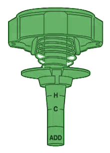

Levels
  • (H) : Maximum level (engine warm).
  • (C) : Maximum level (engine cold).
  • (ADD) : Level minimum.
The oil level must be checked/topped up with the engine off
