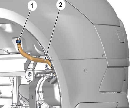

There's nothing wrong with doing that Vlad, - although in the instructions - BEFORE you unclip the collar at 1, you need to clamp the hose at 2 first, otherwise all the LDS will come gushing out as soon as you remove the collar as the LDS is still under some pressure.
Clamp the hose, remove the collar, get your bucket and then unclamp the hose:
