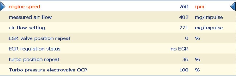

Update...
After further checks I think the Whistling sound maybe coming from the EGR/EGR cooler location. I have replaced the EGR Gasket just in case but still hear same whistling sound around EGR/EGR cooler location.
I have also done a Live data reading and have a few questions regarding the results as I’m a bit confused about a few values.
EGR Value position repeat: = 0%
EGR regulation status: = no EGR
Is the above normal or is the EGR valve faulty and could this cause the whistling if it is jammed?
Turbocharging pressure regulation status: = Not regulated
Is this a fault or is this normal, as all other Turbo parameters seem ok. I have also done a Turbo Solenoid test and that passes ok.

Digital-man wrote: 06 Apr 2018, 15:47 Update...
I'm assuming this is at idle. EGR isn't always used at idle, if you go for a drive whith some wide throttle openings then review the graphs in lexia to see if there is anything amiss.
On my engine when opening the throttle widely the EGR should drop to zero, both on the 'reference' and the 'EGR value position repeat' If this isn't happening then it may be stuck.
However without any EGR fault codes I assume it's working ok.
In addition, 'Turbo pressure regulation status' wont kick in until the engine is under load as you can't build any boost up at idle, therefore a recording of the parameters whilst driving would be more useful.

- Posts: 12552
- x 1480
Re: Boost Error advice needed
I wonder if someone has programmed the EGR out....
See it says the air flow is 482, whereas the reference is 271? The air flow should match the reference value, with the EGR valve open at idle.
I think if you go to Custom parameter measurements (or some such, can't recall exactly what it's called) then you can select which to monitor and it should produce some graphs. You should use Diagbbox not PP2000 fora car of this age...
Take it and boot it, and see what the turbo pressure is doing. If necessary, take a passenger to monitor the data (or drive, so you can!).
