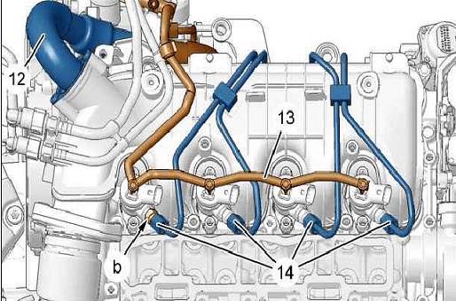

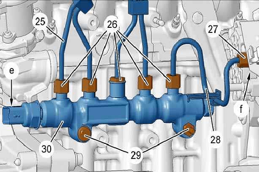

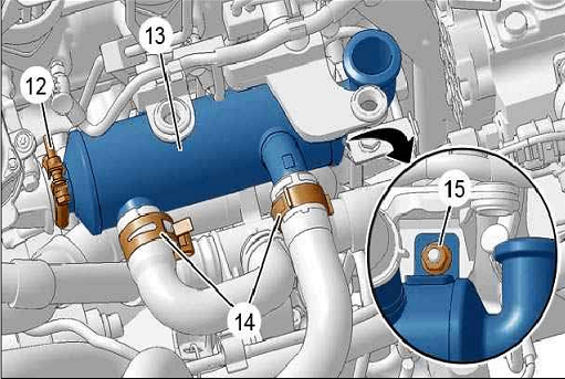

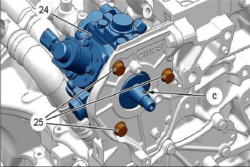

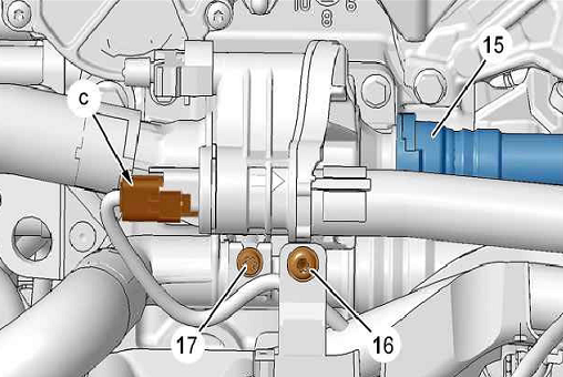

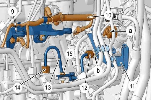

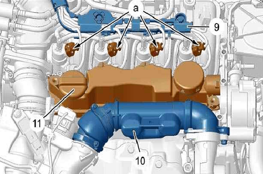

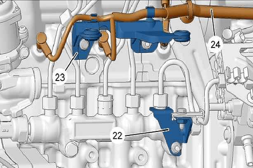

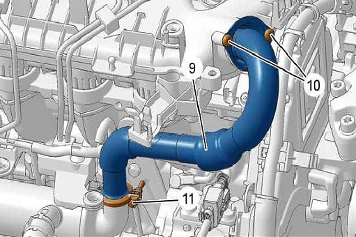

Here are some diagrams that may help - you'll need to click on them to zoom them up.
EGR Cooler Pics
Fuel Pump Pics
Common Rail Pics
EGR Cooler Pics
| EGR Heat Exchanger A | EGR Heat Exchanger B |
| Fuel Pump A | Fuel Pump B | Fuel Pump C |
| Common Rail A | Common Rail B | Common Rail C |
| Common Rail D | Common Rail E | Common Rail F |

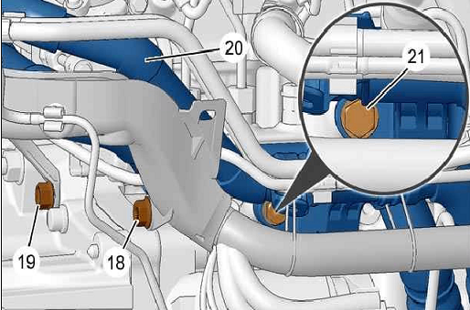

Re: 1.6 Hdi engine photos needed

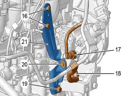

These are going to be a tremendous help- thank you. Are there any more of the fuel pump brackets? In particular I trying to ID some form of red coloured component that fits in somewhere under the pump. I only caught sight of it one time in a mirror- I took it off by feel but I am unsure what it is and where it goes.
I'm not sure what it is, but as far as I can remember it is held in place by a single bolt which was near impossible to get at. It was in the area shown on your drawing Fuel Pump B- and I think it may be bolt 19 that held it in place. I don't think it was a wiring plug.

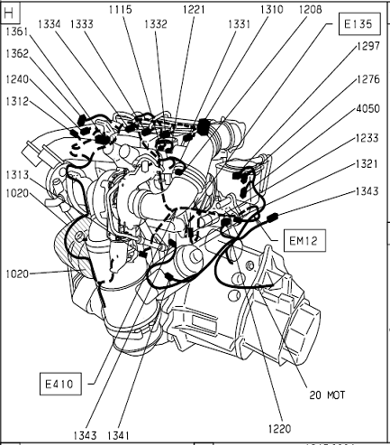

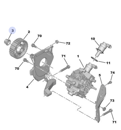

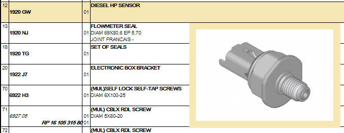

Well I've had a look at the wiring diagrams and can only immediately see 2 red wiring connectors:
1321 and 1221.
1321 is 3 pin, 3 wire red connection
1221 is 2 pin, 2 wire red connection
Here is the parts diagram of the fuel pump and to the right of that is a table of connectors associated with the fuel system: Number 10 is the regulator that then sits into the pump at 1.
In the second set of pictures, part 12 I believe is 1321 in the diagram and is zoomed up for you to see better - this would appear to show a bolt as you describe.
1321 and 1221.
| Code | Description |
| 1343 | Downstream Exhaust Gas High Temperature Sensor |
| 1321 | Diesel High Pressure Sensor |
| 1233 | Turbocharger Pressure Regulation Solenoid Valve |
| 4050 | Water In Fuel Sensor |
| 1276 | Diesel Fuel Heater |
| 1297 | Electric EGR Valve |
| 1208 | Diesel Injection Pump |
| 1310 | Air Flowmeter |
| 1331 | No. 1 Cylinder Injector |
| 1221 | Diesel Fuel Thermal Sensor |
| 1332 | No. 2 Cylinder Injector |
| 1115 | Cylinder / Reference Sensor |
| 1333 | No. 3 Cylinder Injector |
| 1334 | No. 4 Cylinder Injector |
| 1361 | Turbocharged Air Heater Electrovalve 1 |
| 1362 | Turbocharged Air Heater Electrovalve 2 |
| 1240 | Induction Air Temperature Sensor |
| 1312 | Inlet Air Pressure Sensor |
| 1313 | Engine Speed Sensor / |
| 1020 | Alternator |
| 1341 | Particle Filter Differential Pressure Sensor |
| 1220 | Engine Coolant Temperature Sensor |

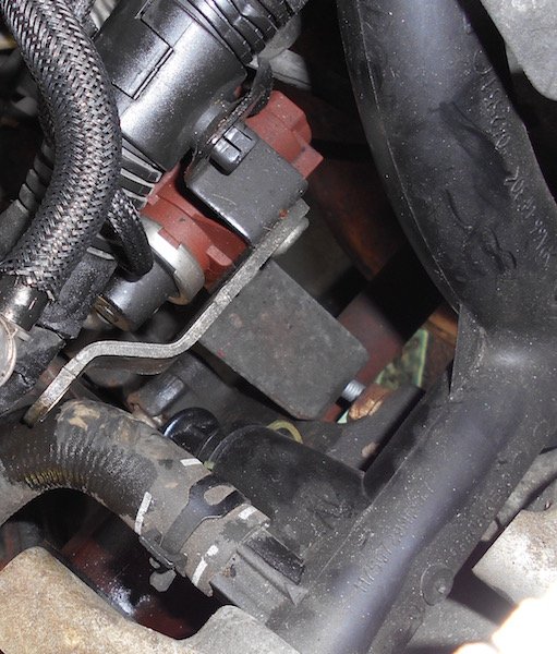

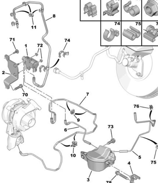

Ok- finally got sight of the component I'm on about, it's looking like it is some form of vacuum operated thingy. Whilst what it is interests me, the real question is where and how does the L shaped, cranked bracket fit back into the right place. It is bolted by 2x bolts to the backside of the block.
C4 Grand Picasso 1.6 HDi 16V FAP/DPFS 110, -Auto (DV6 - 80kW) (C4) (DT) (2006-2008)
Toyota Aygo Black 2007 [well almost a french car!]
Xsara Picasso 2.0 Hdi Exclusive 2005
1220 GS Service Van RHD 1973
OnlineRichardW
- Posts: 12598
- x 1490
That's the boost control solenoid.

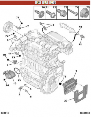

Installation diagram - this is from the front of the engine. Engine removed for clarity
Almost there! Thanks. Now where do the bolts 70 & 71 fit in. I'm wondering if I ever need to take this bracket off in the first place- at this time I can't see it would have prevented me from getting the fuel pump out of the way.

And the answer was- Haynes made the whole procedure up and caused me a lot of grief. The fuel pump and its brackets never needed to come off in the first place.
Separating the pump and brackets from the head required just the removal of 2x 6mm bolts and 1x 13mm nut and its 8mm stud.
I proved the point by refitting pump and brackets first- and then dropping the head on.
